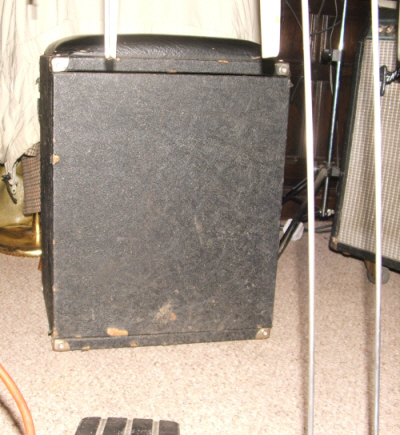

Behind the guitar.

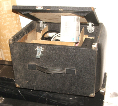

I made mine out of 12mm chip board, covered with "amp" vinyl. Hinged the front and glued (evostick) ply dividers inside for the toys. Furniture gliders on the bottom. For the top I used a peice of ply, slightly smaller than the top, drilled through both to align bolts and used thick foam rubber and vinyl to "upholster it, leaving the bolts sticking down under the foam. That way the thing could pop on the top and the nuts tightened from inside. You can see the hinges and catch in the piccy. Didn't cost much and has lasted 25 years. The pics should be explanatory. The panels were cut for me (to my measurements) at the local DIY store using their table saw and simply pinned and glued using evostick impact. Once it's made up, it's solid but you could glue in a triangular fillet to support the joints, I used fillets on the dividers.
As a box.
I was thinking about this the other week and might have tried boxing in an existing "square", upholstered, stool (the kind you often see in pubs) as an easier solution.
