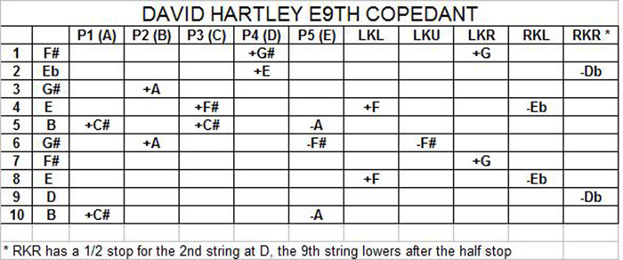

Re: Lower E's on the Right!!!
Postby henry » Wed Jan 29, 2014 2:39 pm
David, I'd be interested to see your copedent if it's possible to post it?

Postby David Hartley » Wed Jan 29, 2014 4:20 pm
TOUCH TO ENLARGE
David Hartley
