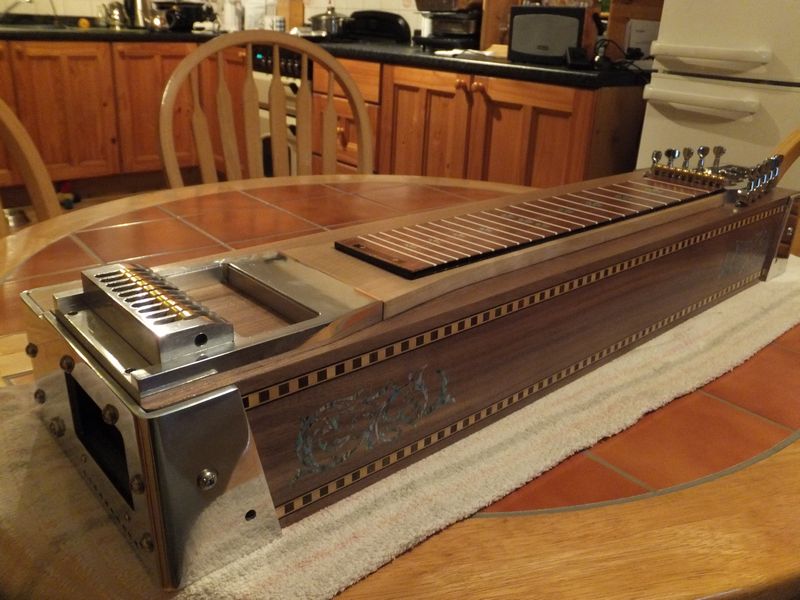

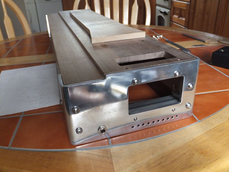

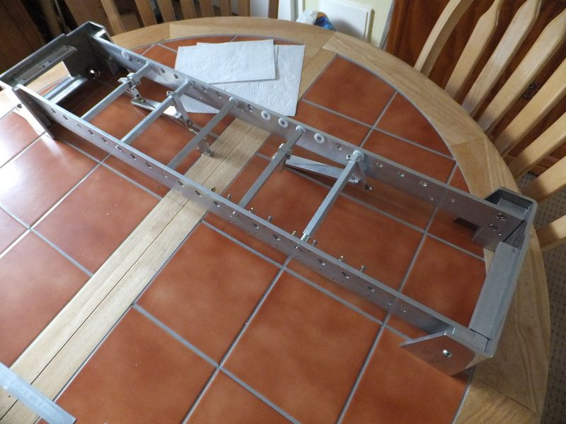

Postby RonMc » Tue Apr 08, 2014 12:08 pm
This is how I did the 'chassis' on mine.
Ron
