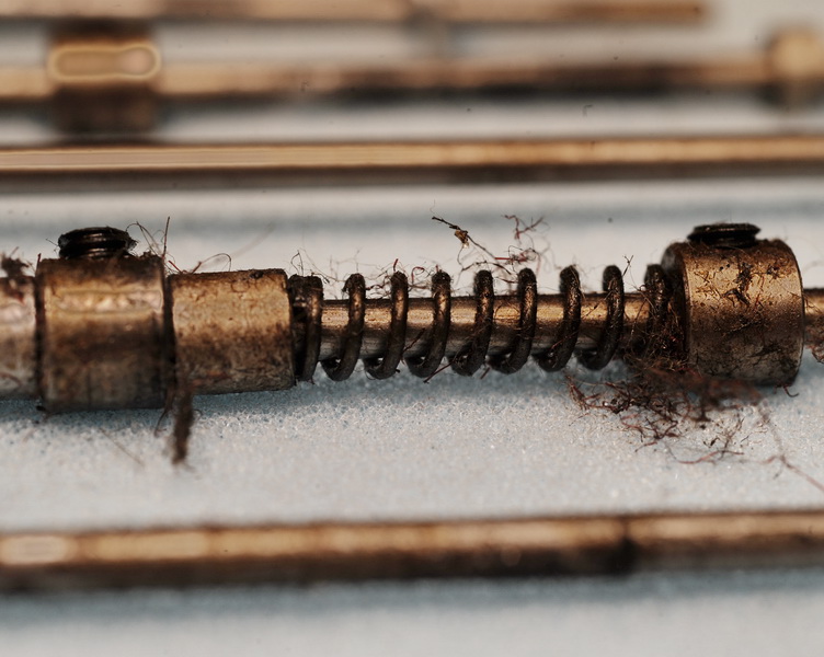

How many of you steel players, particularly working steel players actually clean your instrument? I don't mean just polishing the end plates and the woodwork, I'm talking about what goes on underneath. I'm talking about the changer mechanism the cross shafts the pedals etc., or have the work done by someone who knows what they are doing if you don't yourself.
A few months ago I bought a Sho-Bud that appeared to have lived on a diet of WD40 and nicotine, how the hell it ever played I don't know. the changer mechanism was seized pretty much solid, the cross shafts were as dry as a bone as were the pedals, they just grated.
My latest acquisition is basically a lovely instrument which I am adding 3 knee levers and possibly another pedal. Again having stripped it down to the bones the working parts of the changer were working but the non working parts being the 1st, 2nd, 7th and 9th fingers were solid with what looked like a mixture of grease and definitely nicotine (you could smell it). The cross shafts which needed no lubrication as they were self lubricating bushes were absolutely drenched in, again a mixture of oil and nicotine and once again the pedals were as dry as a bone.

It is actually amazing the difference in the feel of the guitar after cleaning it properly if you haven't cleaned it for a really long time.

I very recently took advantage of the warm weather and took my Sho_Bud into the garden for some much-needed tlc. I gave it a thorough clean and oiling with light sewing machine oil. It brought a lot of gunk from the changer. The result is a much smoother pedal action, smoother changes and reduction in pedal noise. I also had a spring that creaked on RKL which is now smooth and noise-free. Had I left it another week I could have tried one of the alternatives suggested here. Am interested in the 'dry' lubricants as it's clear that, over time, the oil-based lubes attract dust and gunk. Will give the oil time to work but as it dries out I'll definitely give the alternatives a try as they will clean the old oil out as well.
