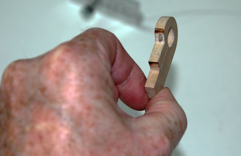

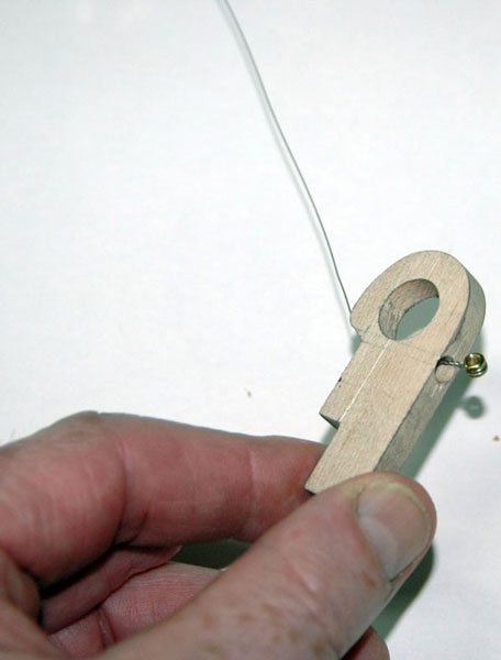

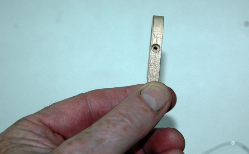

Nick, you weren't doing anything wrong. Everything was quite normal, you just didn't know the fact that one needs 3 hands to change strings on a steel :lol:
With practice you will get better. You'll find a way to hold the string a bit tight so it don't slip out of the slot or off of the pin.
On my BenRom steels, I have made things a bit easier by drilling a hole thru the finger. That way, you just stick the end of the string into the hole, pull it out the other side, as demonstrated on these wooden finger models. Once you have done that, you leave that end be and concentrate on getting the string into the post hole of the tuner. Like McGyver used to say "Works for me".
