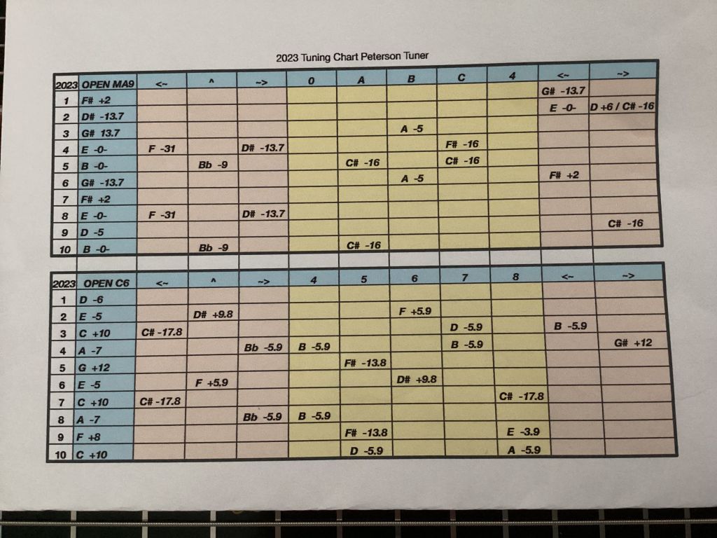

Mickey, I used the tone generator in my StroboPlusHD to play each note while checking it against ET using the PitchlabPro phone app. (The app has a easy-to-read display showing Hz and + or - cents) These are the values I came up with for your MA9 tuning. Does this sound about right?
F#...(-0.5)
D#... (-13.5)
G#...(-13.5)
E...0
B...0
G#...(-13.5)
F#...(+2)
E ...0
D... (-5)
B... 0
A...(-5)
Bb...(-9)
C#... (-16)
F...(-31)
G...0

Postby Gordy Rex » Sat Jun 03, 2023 12:29 pm
Hello from USA…
using the MA settings I created this chart for both necks on my Emmons. I have found this works for me..
