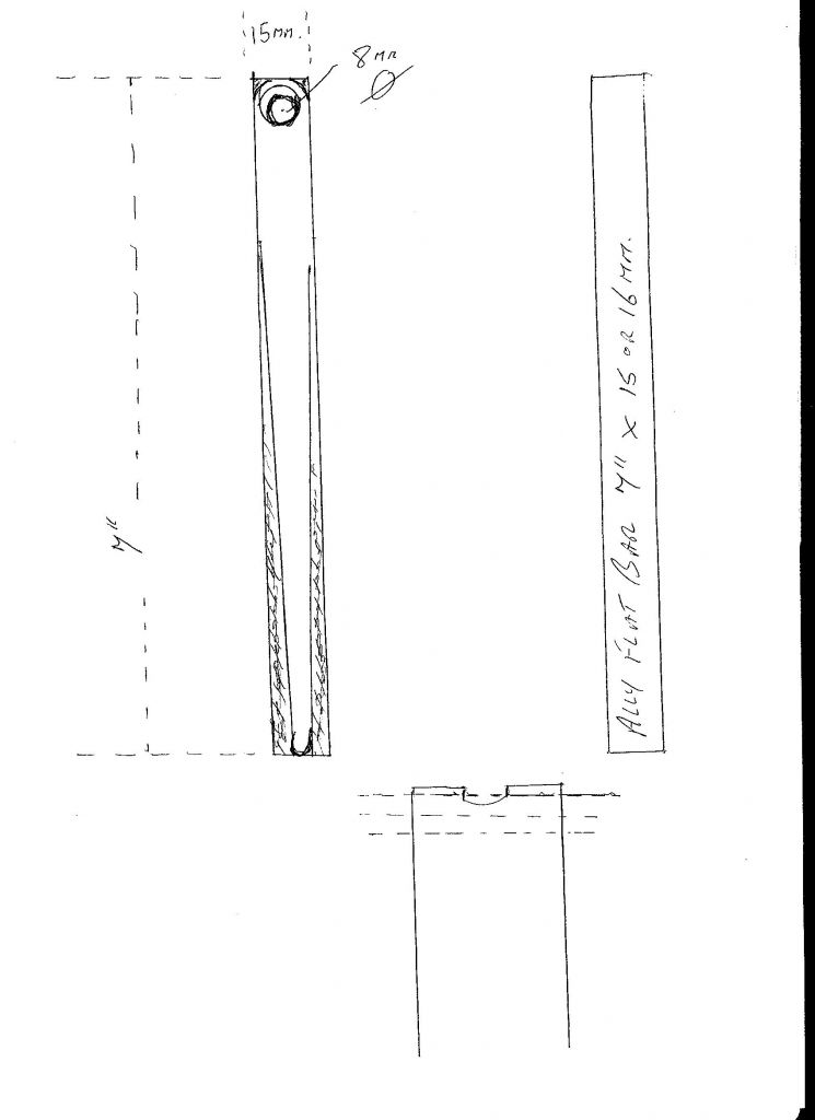

It depends on what you want it to look like when its done ..... If I use an old Bennett foot pedal for a knee lever (not very pretty but functional ) probably nothing more than getting it up here..... but the pro flat ally levers are not difficult to make if you buy some ally flat there is not much machining to do, I have made them with a hacksaw ,drill. and a vice they looked ugly but they worked so, you pays your money and you make your choice.... there are lots on here that have milling machines etc and some would trim down and taper some ally flat just for the hell of it... ask'em....
Something like this..........

JohnDavisStringsHere wrote:It depends on what you want it to look like when its done ..... If I use an old Bennett foot pedal for a knee lever (not very pretty but functional ) probably nothing more than getting it up here..... but the pro flat ally levers are not difficult to make if you buy some ally flat there is not much machining to do, I have made them with a hacksaw ,drill. and a vice they looked ugly but they worked so, you pays your money and you make your choice.... there are lots on here that have milling machines etc and some would trim down and taper some ally flat just for the hell of it... ask'em....
It'd definitely worth considering. As it is/was it only had the one knee lever which dropped D to Eb. What would a second add? I wonder if there were any ZB parts for sale online with the same knee lever so it looked like it belonged there.
