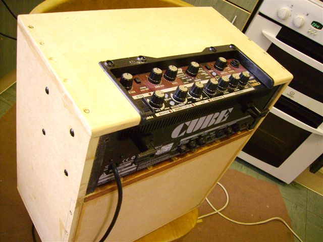

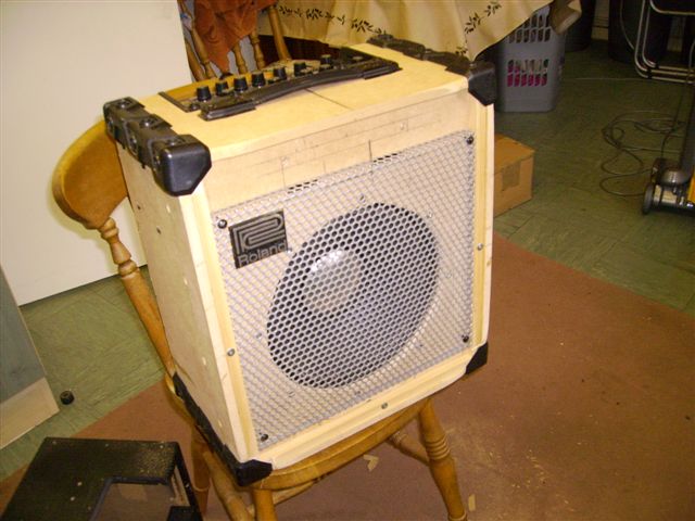

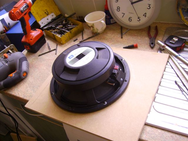

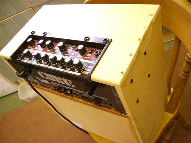

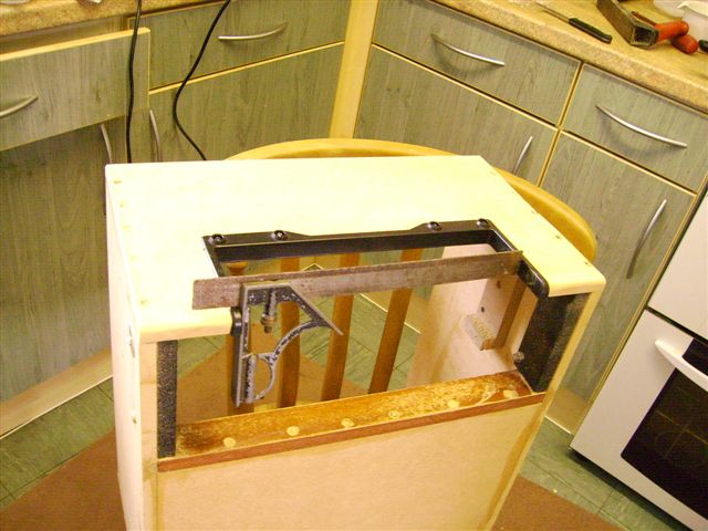

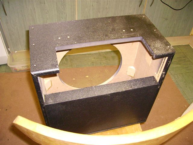

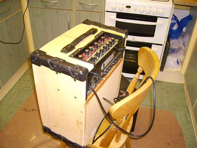

you can buy either the Roland 80X or the Roland 80 XL- (Both discontinued now so cheap as chips ) The XL has a few more Gizmos on it to impress the guitar players but you don't have to use them and the basic amps are the same but, if you want to turn your cubes into little sound monsters..... what I have done (follow at your own risk) is remake the cabs 60 mm taller, its not that difficult B and Q will cut the 10 bits to size for you then you will be able to fit JBL E120's and the difference is jaw dropping! that's not to say you cannot manage with a couple of cubes but the effort is so worth it IMHO.

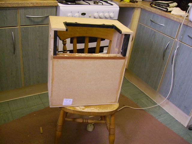

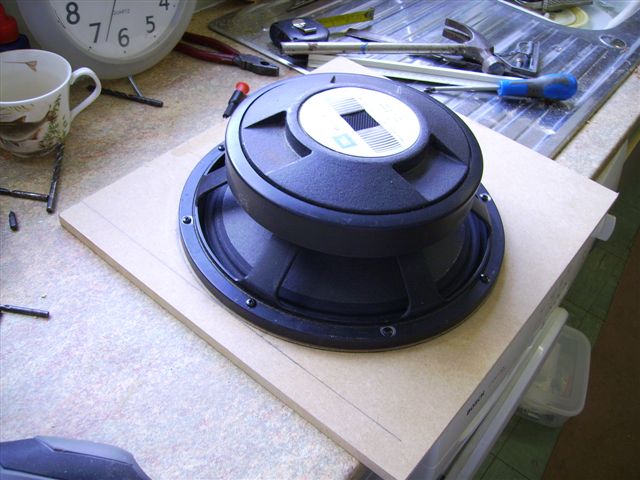

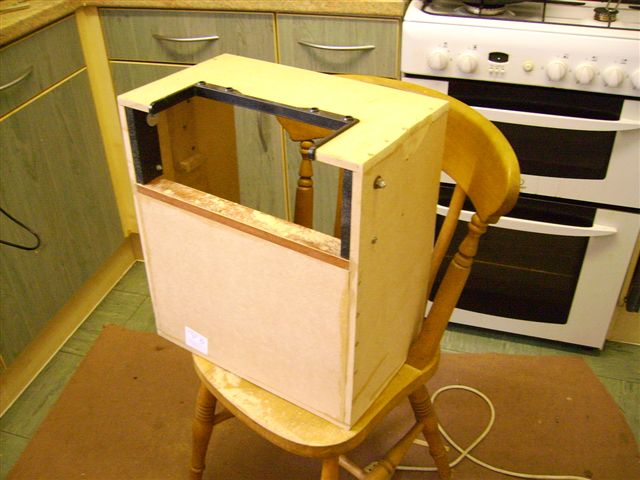

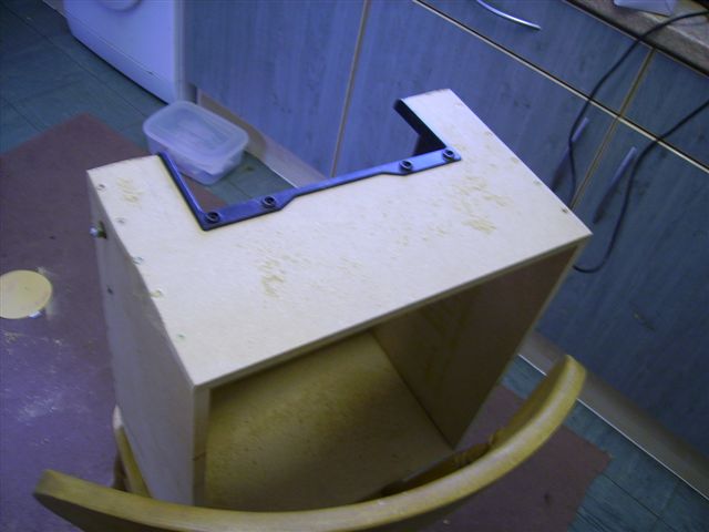

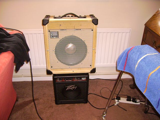

I have posted these pics before but cannot find the relative thread but the advantages of having a set up with two of these. If one goes down or anyone's amp in the band goes down you have a spare and yes one would do the job for you (Just about) and you can get through the night, having ex. speakers more to carry take up more storage space and IMHO do not cut it like a supercharged cube. even with an E120 in I can still carry one in each hand though I do tend to use a trolley these days. I like to set the up one on top of the other, just use the effects on the top one , the bottom one is just there for extra muscle.
