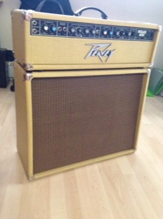

Thought this might be of interest. I have removed the amp section of my Vegas and covered the cab in tweed. New baffle. Constructed a cab for the head. Much easier to carry. Not using reverb as use digital unit.

A good Job Derek. Very practical and professional. 8-)

Let me get this right 'cos I might want to do it. The speaker enclosure is the whole of the original cabinet, amp space and all? Just a new baffle. Then the amp section gets a new box. What wood did you use - 3/4 ply? maybe thicker? or some other timber?

Yep the cab is the original Vegas. Made a new baffle cover with oxblood fret. The actual speaker baffle remains the same so the amp can be refitted if required utilising the original fret. The amp cab is 18mm ply glued and screwed.

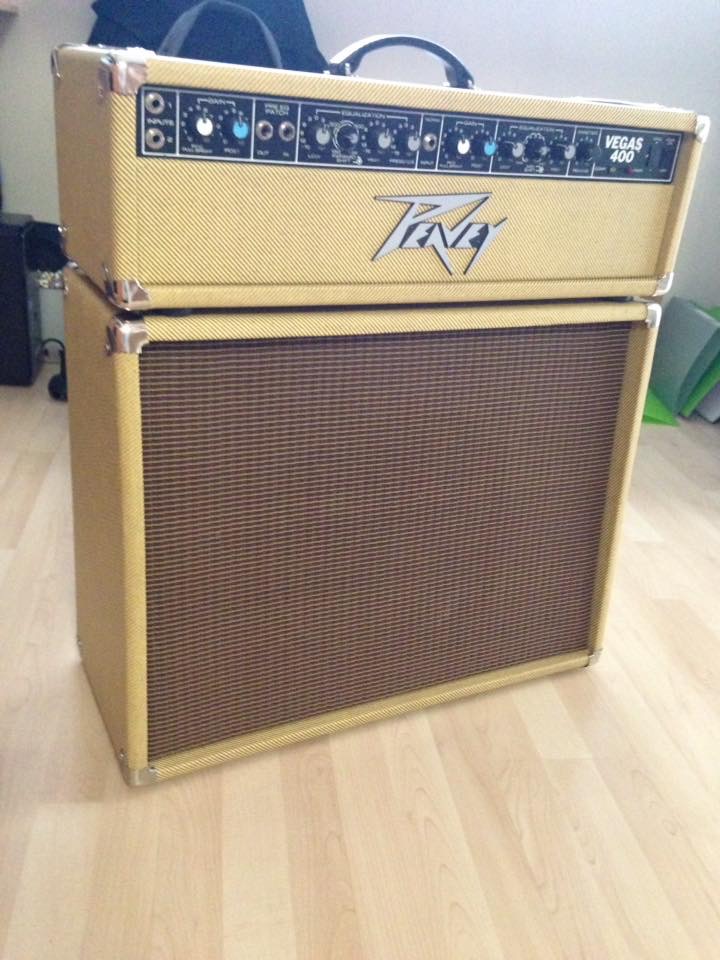

Completed task. New cab for the amp unit and recovered the original carcass to match. New speaker grille and 15-4 Telonics. Omitted reverb tray but could fit send and return on the speaker cab if necessary.
