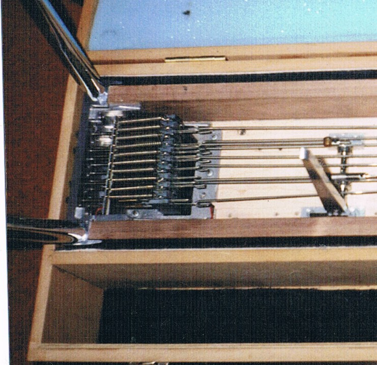

Back in the early to mid 70's, Eric Snowball imported a few Fuzzy's as they were relatively cheap and cheerful. The Fuzzy was a forerunner of the Excel built by Mitsuo Fuji. The very first ones looked as though they were modelled on the push pull system, and one that I took home from Maidstone to sell as Eric's area agent had what I suspect was a basic pull release. I remember that it stayed in tune pretty well in the open position, but wasn't as solidly constructed as the American built guitars of the day. They suffered with chronic cabinet drop, and would detune like mad if excessive downward pressure was put on the bar.
I looked at an old picture of an 80's Fuzzy on the USA forum from 2006 in the 'for sale' section yesterday, and the changer looked like late 60's Sho~Bud. Therefore it's fair to say that Mr Fuji's Fuzzy underwent a number of mechanical changes, and therefore unless there was a photo of the changer and endplate, it would be difficult to say for sure what the pull system is as there were different mechanical pull systems.

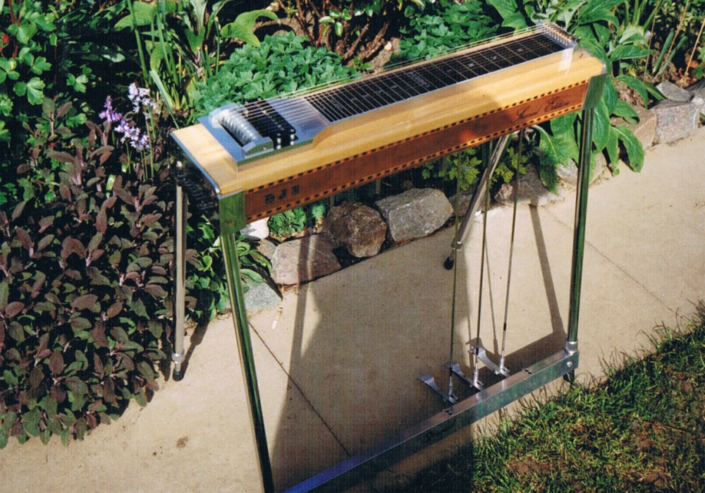

Postby SHAKEY » Sat Apr 02, 2016 6:41 pm
This is a steel I built sometime in the early 80's, all except for the actual pedals and the changer which came from a Fuzzy. The pictures are not brilliant but you can see that it is an all pull system and the raise and lower stops are through the end plate the same as the ZB. I believe it is still knocking around as it was sold on ebay some time ago.
