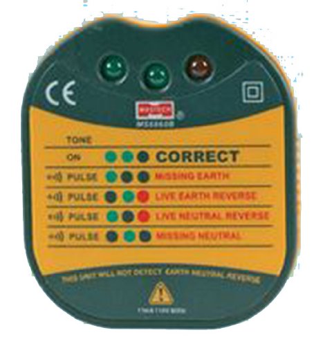

Postby Ken Byng » Wed Jun 03, 2015 7:47 am
I have had a few 'belts' over the years at some venues, especially at antiquated village halls and social clubs. I expect that some of our older members have too. At one venue in the 60's our power supply was at the end of a very flimsy trailing lead that was plugged into a light fitting as there were no wall sockets on the stage!! Needless to say we didn't play that one as there was a real fire risk from heat generation at that light socket plus we would have had no earth. In the late 70's I started to get into the habit of using a small mains tester when I first arrived at the gig. (See below). These little units will disclose any basic wiring problems when you plug them into a mains socket. If there were any problems I would make the person in charge of the venue aware that their wiring was faulty, and refuse to play until it was sorted out. Almost all venues these days have to have some form of certification on their wiring, plus annual PAT tests. However, even now I always use a trailing lead with a circuit breaker plug on one end to avoid Bob's scenario from happening. :o :o
