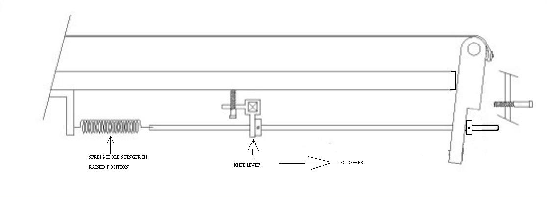

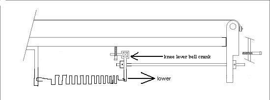

Postby Zebedee » Tue Oct 21, 2014 6:46 pm
It's very useful to be able to lower the 2nd and 9th strings a full tone and a half tone respectively, and this is usually done on the RKR lever.
I think that your steel has a pull-release changer mechanism (but I could be wrong), so the 2nd and 9th fingers would need to be held in the raised position by springs.
ZeBedee aka the spring man

Re: Should I add levers or upgrade?
Postby Will C » Tue Oct 21, 2014 8:32 pm
Richard, I know it's a while since I had my Marlen, and I'd be the first to acknowledge your experience with those old pull-release changers, but I always thought the fingers were held in the raised (i.e. normal) position for 2 & 9 by string tension alone? I seem to remember the fingers are held against the abutments on the pullrod and then, when you operate the knee lever, you release that tension, so the note lowers. Or are we both saying the same thing? :roll: :roll:

Postby Zebedee » Wed Oct 22, 2014 4:56 am
A picture is worth a thousand words

Postby Zebedee » Wed Oct 22, 2014 5:04 am
An alternative
