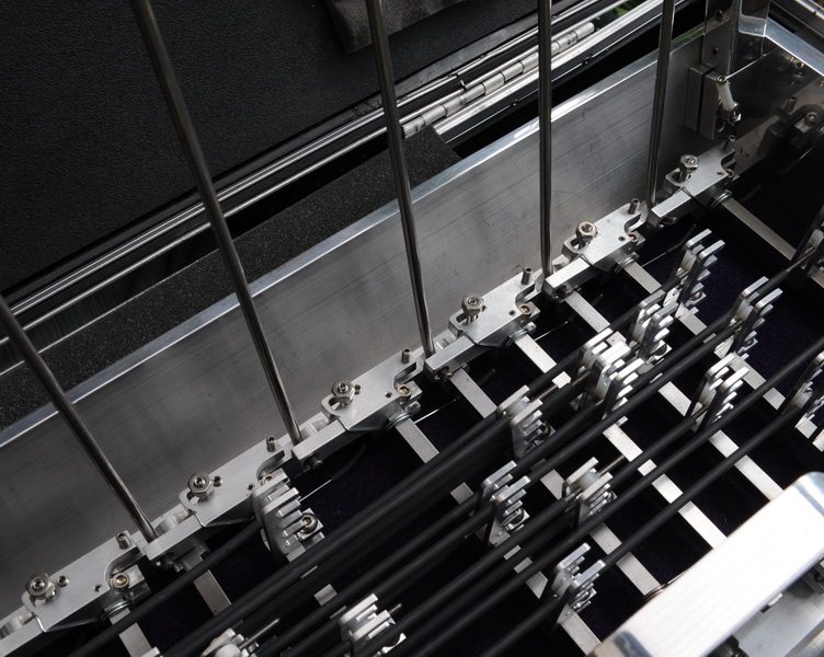

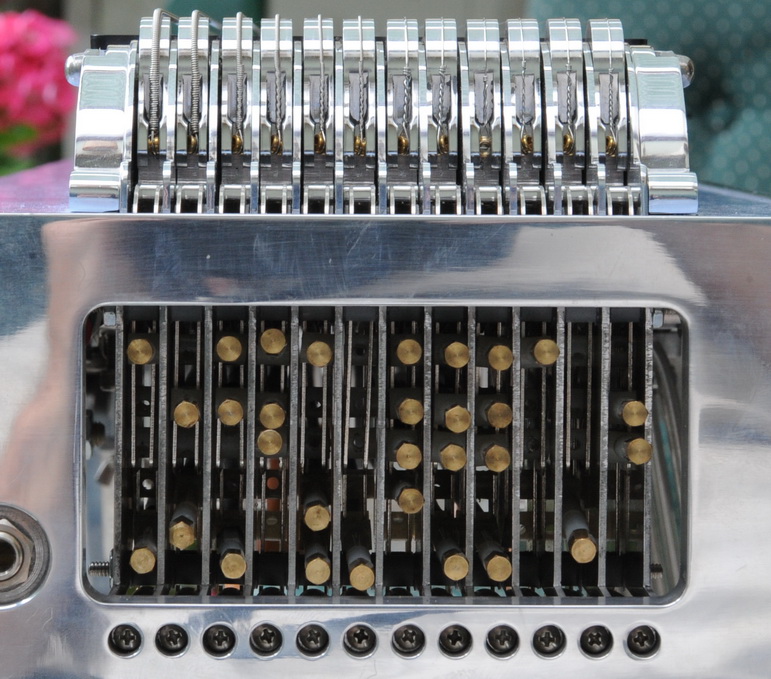

Does anyone know the diameter (it looks dead like 1/8in, so really just checking on that one) and the (important) thread cut on pull-rods in Sierra (Herbie Wallace) Crown series? In order to re-position some pulls, I need to shorten and re-cut the threads on a couple of rods :geek:
I have never owned (or worked on) a Sierra until now, so it came as a surprise :o to find the tuning nut (brass) braised onto one end of the rod and the thread on the end where it goes through a (tapped) nylon barrel in the bell-crank. Apart from ZBs, I'm used to the screw thread being in the nylon nuts at the changer, on an all pull.

I'm sure they are 1/8th from memory Tony if so a 4BA die would do the job for you!
Stuck the pics on for those who are unfamiliar with the guitar.
