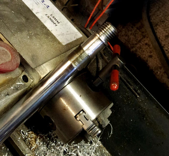

If not I have a temporary solution for you, I've cut a stud in alloy which will at least get you on your feet until you can locate a steel one.
I'm not doing much on engineering these days as I am too busy on other things but I had a couple of bits to make today so knocked this out at the same time! ( No worries if you are sorted already!)
1, I don't have steel around that diameter nor do I have the means heavy enough to cut ¾" BSW, it was struggle enough in alloy in the vise with a ¾" die nut!
I'm not sure whether your existing one is press fit or brazed in, if pressed it can be forced out, if brazed it would probably need to be cut and the length adjusted at the bottom on the insert leg, not ideal but it gets you going (your call)

Not a good idea to use aluminium, Bob.
An aluminium bolt threaded into an aluminium nut has a high probability of binding (galling)

How right you are Richard, I was trying to come up with a quick temp. fix. but there is a risk there is no doubt. Well greased it might be ok, short term but steel is the route to go for sure!
