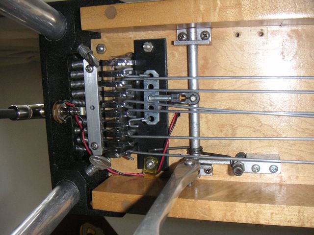

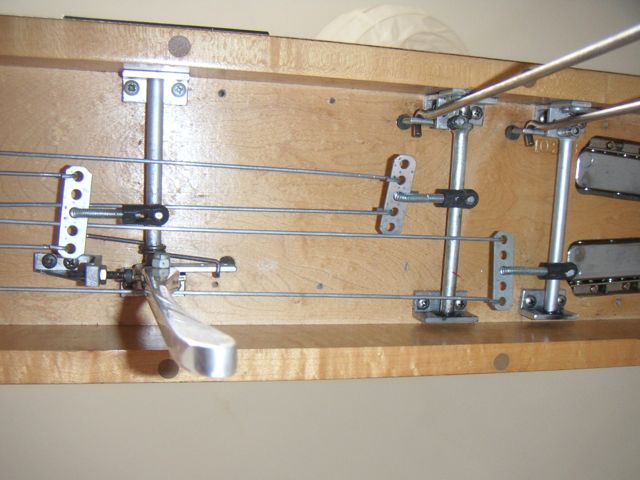

Postby Zebedee » Tue Jun 11, 2013 9:07 am
Post a picture of the underside of the steel, so we can work out the copedent.
Without knowing the setup, it's difficult to offer advice

Postby CluelessJim » Tue Jun 11, 2013 1:50 pm
Is this clear enough to see what's going on?
Much appreciated,
Jim

Postby Zebedee » Wed Jun 12, 2013 5:46 pm
OK, it's standard E9 setup (Emmons, not Day), minus the 'C' pedal.
The 'A' pedal (nearest the headstock end) raises strings 5 and 10 a tone, the 'B' pedal raises 3 and 6 a semi tone, the left knee right (LKR) lever lowers 4 and 8 a semitone, and the RKR lowers strings 2 and 7, probably a semitone.
To tune a string that raises, (say the 5th string) press and hold the 'A' pedal and tune the string up to its raised pitch at the keyhead.
Release the pedal and tune the string to its open pitch using the tuning screw at the changer end of the steel.
To tune a string that lowers, tune it to its open pitch at the keyhead, then activate and hold the knee lever and tune the string to its lowered pitch using the endplate tuning screw.
