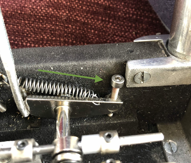

Postby Rigby » Mon Mar 30, 2026 6:38 pm
Does anyone know the size and thread of this bolt?
I need to get a shorter one as the head is hitting the metal part before the tip hits the cabinet.

Re: Machine screw that sets pedal travel on Emmons
Postby JohnDavisStringsHere » Mon Mar 30, 2026 8:05 pm
how about take it out find a couple of nuts that suit the thread and wind em on it then cut a bit off and use the nuts to clean the thread before replacing it

Postby Rigby » Mon Mar 30, 2026 9:00 pm
I doubt I have any nuts that fit, it'll be an Imperial size for sure. Not to worry, I can take it into BAPP tomorrow and get them to hunt for something.
Postby bob adams » Mon Mar 30, 2026 9:01 pm
6/32 ;)
Posts: 1741
Postby Rigby » Mon Mar 30, 2026 9:38 pm
Thanks Bob.

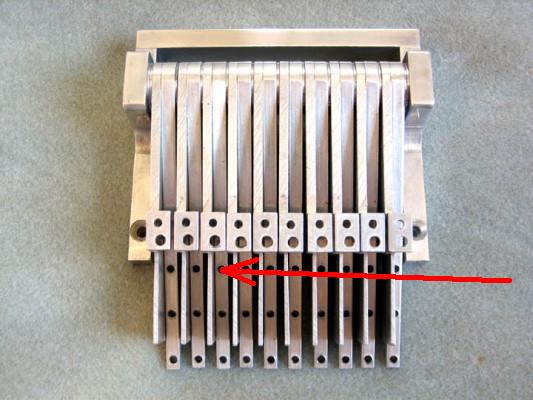

Postby Zebedee » Tue Mar 31, 2026 1:24 pm
You need to have more movement of the changer finger without much altering of the C pedal travel
This can be achieved (albeit at the expense of a slightly heavier C pedal and F lever pull) by making sure that the raise hook wire is in the changer finger hole nearest the axle
ZeBedee aka the spring man
