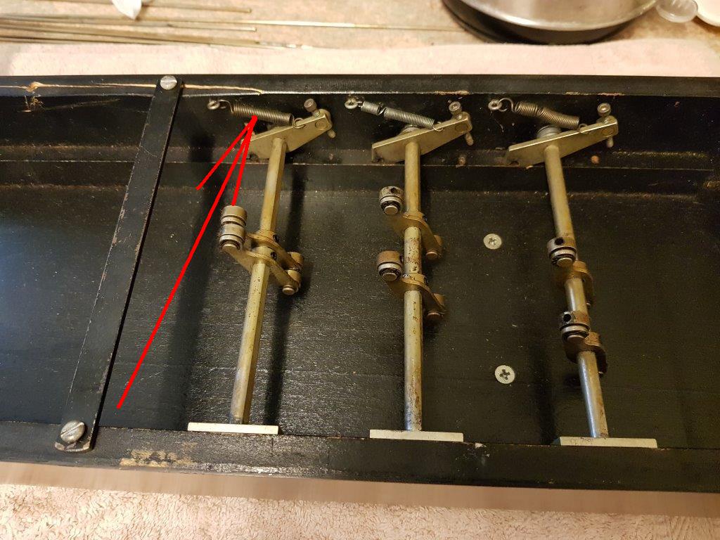

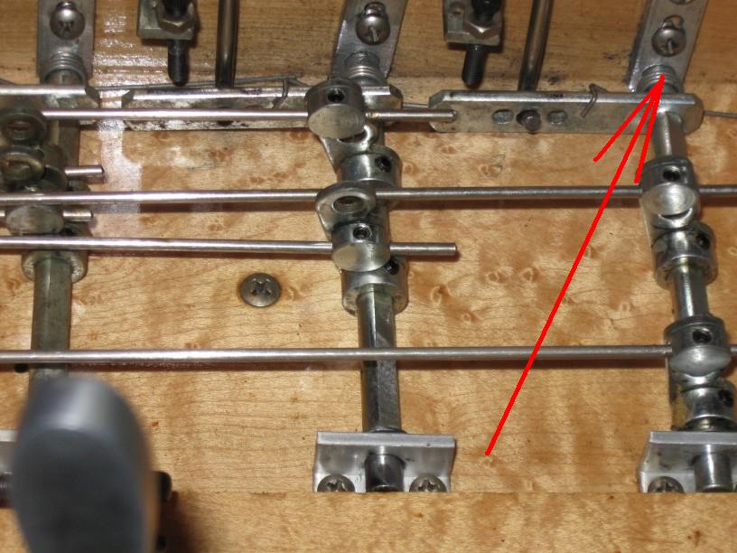

Most steels have a spring that holds the pedal in the up position.
This allows for a slight amount of movement of the pedal before a string is raised (if the pedal stop is correctly set)

Great to have a picture Richard. The bracket and screw are plain to see in the second photo, to the left of the arrow.
