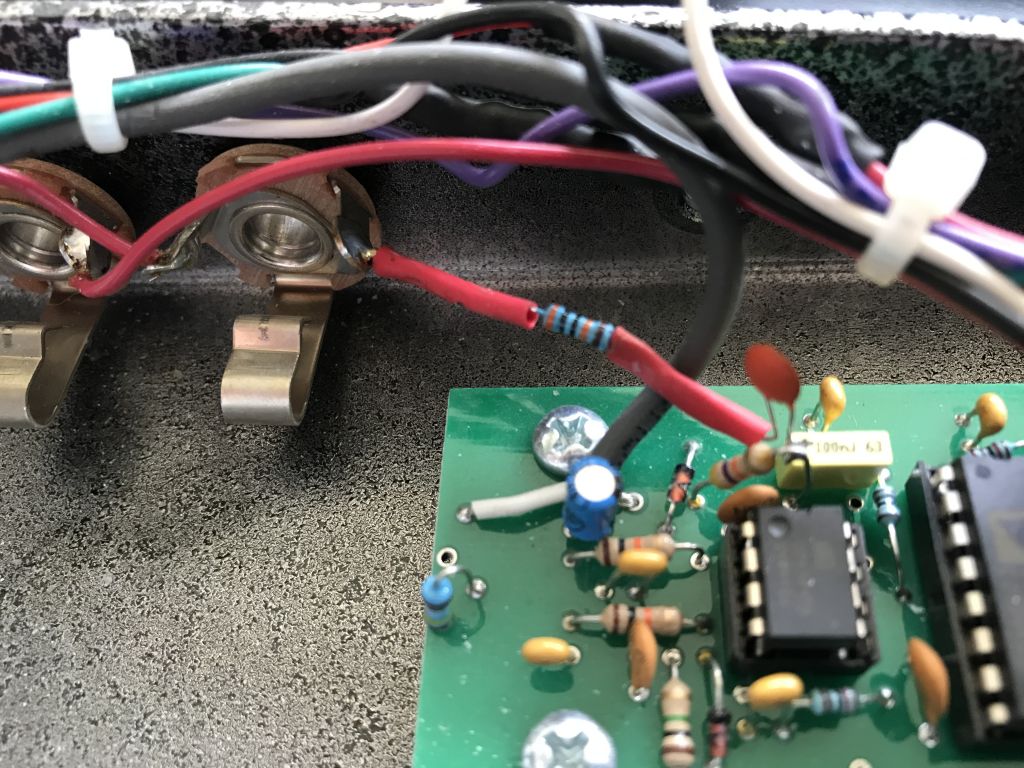

Just managed to get around to doing the simple mod to my Hilton volume pedal to get a tuner out signal from the second output jack. Very easy to do and just needs a 0.1µF capacitor and a 300k resistor. Took about 5 minutes. Since getting my Peterson HD tuner I’ve always had it inline as it was nice and handy. Bad idea! The difference in both tone and volume was staggering and the tuner also seems much more stable with the direct signal. I think because the Peterson was so reassuringly expensive I just assumed it wouldn’t affect the signal much as I knew my previous Boss tuner sucked tone even through the bypass jack but I should have experimented earlier. Had to adjust both tone and volume on the amp after the mod. Highly recommended mod!

Any chance of a photo, of said mod, Calum? Intrigued of Hillington.

Here you are Danny. The cap goes on the top of the sticky up resistor and you can use either socket for the tuner out.
