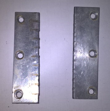

I have stripped down my Fender Artist D-10 for maintenance and find one pivot blade badly worn in three places, the other worn a bit less. For those not familiar with the thing I'll explain. And, by the way, these Fenders are the ones with the ShoBud undercarriage.
The fingers do not pivot on a rod. The fulcrum is a knife-edge and the fingers have a ">" shape that sits on the knife-edge. This results in almost no friction. The "blade" is some alloy or aluminium (too light and too worn to be steel) and 3.5in x 1in x 1/10th in thick. I don't think the thickness is critical; 2.5mm or even 3mm (with the edge filed a bit sharper at the edge) would do.
Does anyone have any ideas what material I need to search for? I'm not familiar with aluminium grades. I even considered 3mm brass :?:

Here's a picture - note the wear on the right one.

Hi Tony. Don't know if it is any help but when you watch videos on steel guitar construction they seem to mention aircraft grade aluminium (or aluminum as they say over the pond). Apparently it's a lot stronger than the regular stuff. Looks like its available on fleabay as 60-- series.

If you use hard-wearing material, you run the risk of ruining the changer fingers.
It's easier to change the plate than change the fingers, so don't use exotic aluminium, use something bog-standard
Having said that, I've never seen one of these steels, so could be talking piffle

Your guitar is over 40 years old. Replacing the old aluminium blades with the same grade material would give the guitar another 40 years. I always felt that the Fender/Sho~Bud Artist changer gave a really smooth pedal action. (Thank you Gene Fields). A small engineering company could knock a load of those blades for not a lot of money and you would get a very straight knife edge too. Cheers, Ken.

Thanks to all for the input. The blades are definitely ali or a non magnetic alloy.

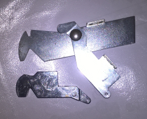

Richard - you've hit it right on about the hardness issue, wearing the fingers was my worry from the start. For your info (I know you like this sort of thing) here's a pic of the parts that pivot on them. Much the same as a SB scissor action without the rod.

My latest wheeze (if I can't sort it soon) is to turn the worn one over, re-drill the holes and put it back in using the sharpened opposite edge as the pivot.

If you draw a blank Tony I can make these for you in 3mm alloy.
The grade if critical would be 6062 (commercial extrusion spec)
I've used it for many parts over the years and it has never given me any issues.
