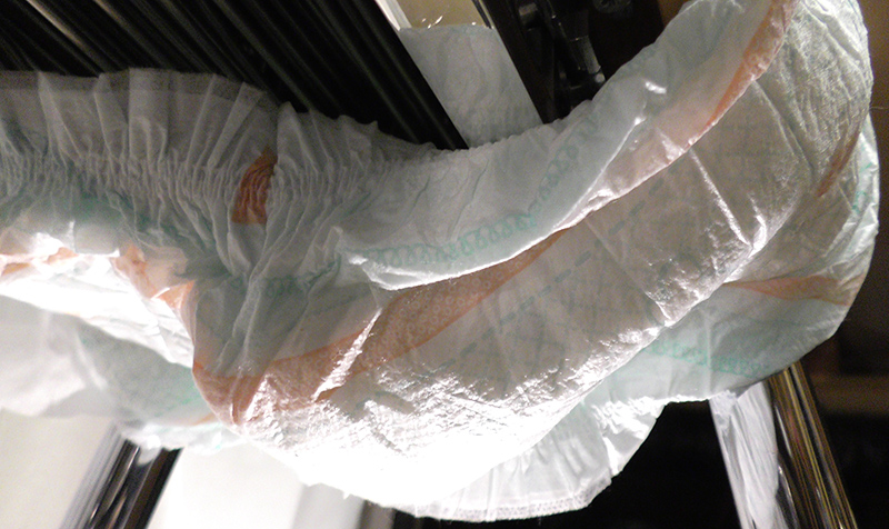

Having a wee break from this today, so thought I'd post up some of what I have done so far.
Day 1

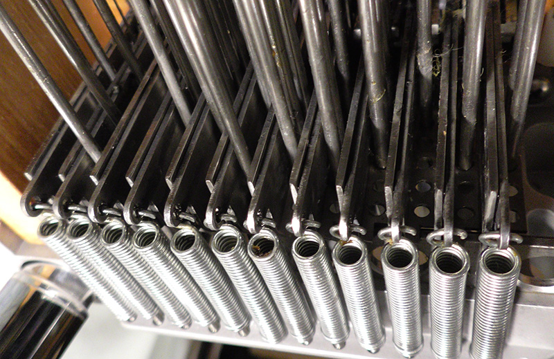

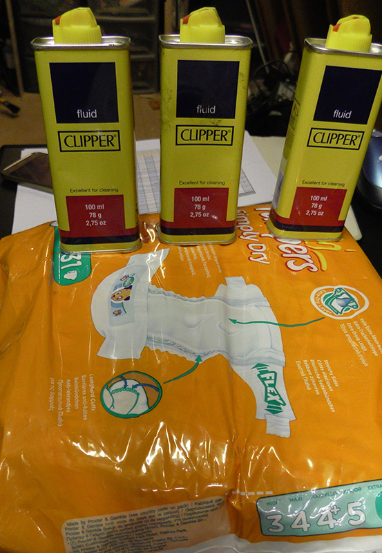

First thing I did was a changer flush and re-oil. TBH it looked pretty clean but thought it would be nice to start with a fresh changer.

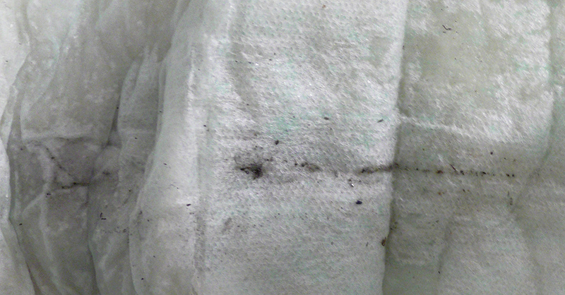

Below are the essential tools I used for this job. The lighter fuel which is essentially Naphtha is a great cleaner for this purpose, the nappy catches the fluid and residue. I like to jiggle the pedals and levers when I'm doing this to get into the parts other fluids can't reach ;) The 3rd photo shows the resulting residue, not much there, when I did my Carter, an older guitar, there was loads of gunk, so worth doing every now and then.

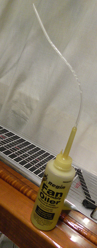

The photos below show the topside and underside of the changer after cleaning, looks nice and shiny! I then oiled the changer from the top using Regin Fan Assembly Oiler, this is what MSA recommend for lubing their steels. I used to use sewing machine oil but this seems to be finer and works really well. The bottle also has a long extendable spout which is useful for reaching those tricky bits.

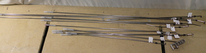

Day 2

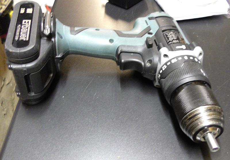

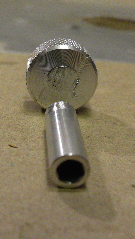

On Day 2 I prepared some tools, got the steel onto the stand and got started. First off I took an old tuning peg tool and sawed off the end so it could be used in a portable drill to quickly remove the pegs. I put the drill on a very low torque setting and removed the pegs from the rods that were coming out. I wouldn't recommend using the drill to put the pegs back on, I never tried it but reckon it could have led to stripped threads or going too far onto a rod, I wanted to keep them slack when back on the rods so I wasn't pushing down a pedal and snapping a string.

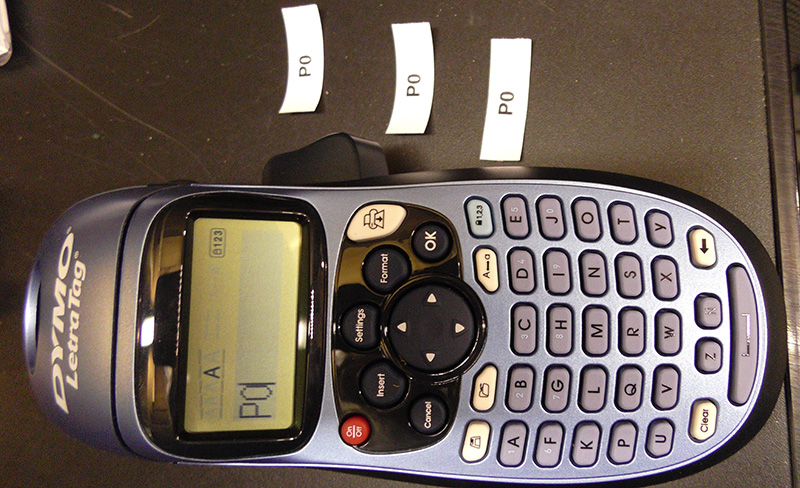

I bought a Dymo labeller from Lidl for a tenner and used it to label the rods as I removed them, labeling them for the shaft they had come off, i.e. P0, LKL etc, this made it easier to identify where they would be used later. I have found this handy throughout the conversion, also when I have stripped back all the rods on a string to fit a new rod. Well worth the investment.

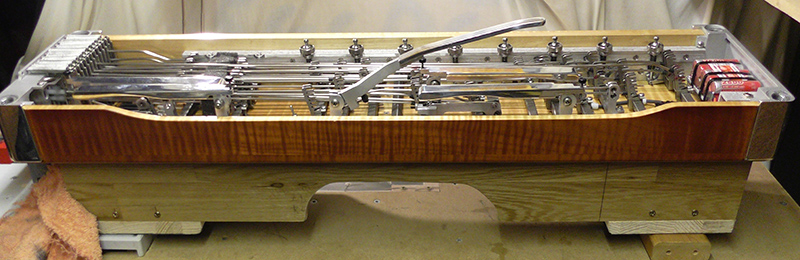

Re: Uni to Ext E9 Conversion
Postby Jif » Fri Dec 18, 2020 2:53 pm

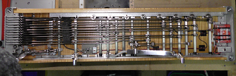

On the stand, ready to start.
Underside before rod removal.
Underside after rod removal.
Postby Jif » Fri Dec 18, 2020 3:18 pm
Removed Rods.

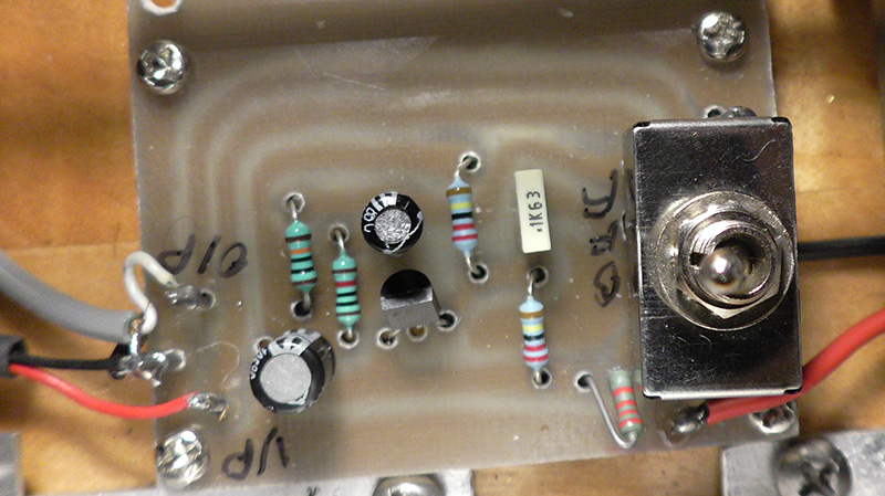

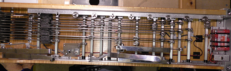

Often when folks have looked at the underside of my Legend they ask - "What are the batteries for?" The answer is they are used for the fretboard underlighting, this is a great feature of the modern MSA's and is built into the steel when constructed, it has to be specified when ordering and adds to the price but has been well worth it.
I also utilised the batteries to power my version of the Little Izzy type circuit. Essentially it is a very high impedance input unity gain amplifier, from memory around 2.2M ohms, which doesn't load the pickup as much as going straight into the volume pedal. The result of this as folks with a Little Izzy or similar will know, is less treble loss and a brighter sound. The circuit has a unity voltage gain but boosts the current travelling down the cable which leads to less treble loss through the cable, so it's a win/win. Very simple circuit, essentially an FET configured as a source follower for all you geeks out there :ugeek:
Here's a close up of the pre amp. I fitted an on/off switch to it, I originally had it wired so that the jack plug into the guitar connected in the power but kept forgetting to remove the jack and hence flattening the batteries. I mostly remember to switch it off as it is a definite act. The switch also bypasses the circuit in the off position, so the pickup is then connected straight to the jack, so if I'm out playing somewhere and the batteries die I can still play.
