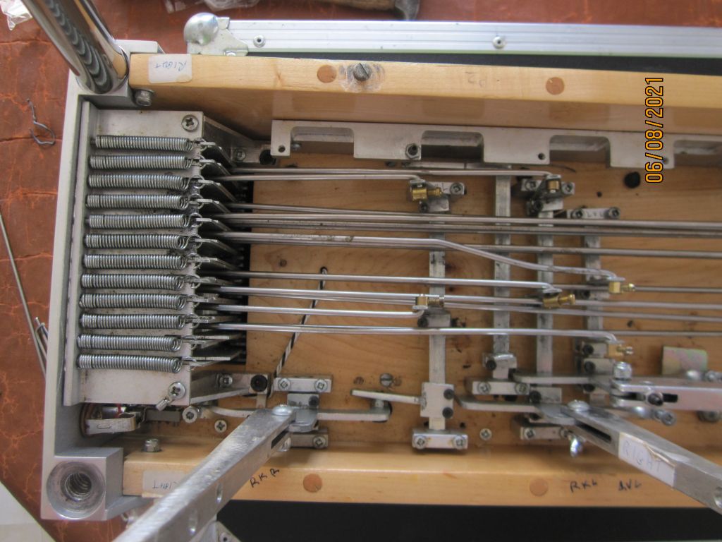

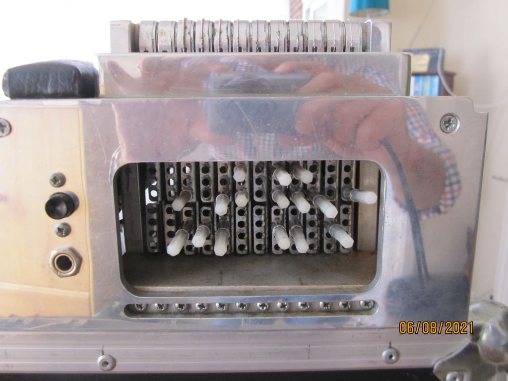

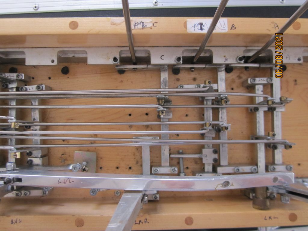

Its great to see some banter as well as encouragement! NEWS - I THINK I've finished the re-rodding [I've done it using the chart Pete Lindsley sent me!] I'm quite proud of the progress but I'm sure there are many hours of 'adjustments' to come yet assuming it is correct so far. My comment about engineering was prompted by the fact that I had to make a couple of parts using an old 3 pin plug and I also had to shorten a few of the rods. [better than having to lengthen them!]
I've posted some photos of the final rodding result though I use the word final reservedly! I'm looking forwards now to the next stage but at the moment I haven't a clue what that is!
keep well guys
Gerry

Well some good news! I THINK I've done it! after many hours of re-rodding and repositioning then even more hours, of re-rodding, re-re-rodding, repositioning,
re-repositioning, re-mechanic-ing, looking confused, penny-dropping moments, making bits and playing with my good sensitive guitar tuner, I've now got all the pedals and all the levers, pulling all the correct strings, to all the correct pitches! according to the Copedent I have. Extra thanks to Pete Lindsley who has been guiding me wonderfully and encouraging me via email. If I haven't missed anything then as far as I know the next step is to find or acquire a volume control pedal [any suggestions?] and find some time to actually sit at the instrument and begin to learn how to play it.
