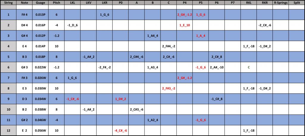

Minor update on this, I'd forgotten that the substitution of a D at string 9, it was a B on the Uni setup, would not work with the B6 change I retained for pedal 6. So I've added an extra change on pedal 6 to lower the D to C# which will work with this change. I tried this out raising my current string 9, B to C# and it works fine, string 5 raises to C# in any case so it's just an octave down on string 9. The change works well either in conjunction with lowering the E's or on it's own, so gives me two options on this pedal.
First thing I'm going to do is a changer flush to clean out all the gunk, so it's time to locate the disposable nappies, (some of you may remember the thread I posted on this, the nappy being an essential tool for this job :lol: ).
Once that is done, I'll change the bottom strings to reflect the new set up, I'm going to retain the old strings that are on it until I've done the rodding then put on a new custom set I ordered from Live Steel strings. This means I have to move current strings 9-11 down a notch and put a D string into position 9.
I've just ordered a Bill Lawrence 712 pickup to give me another option, (thanks for the suggestion Ken, I listened to Mickey Adams pup comparison on a Legend and the 710 sounded really sweet), I already have a Tonealigner and a Wallace Truetone. As many will know it is possible to easily swap out pickups on the new MSA's as they slide in and out of the pickup holder/mount. I just ordered the bare pickup from Wilde pickups and will make the MSA mount myself, I've had a look at how they've made these and don't think it'll be hard to replicate. I was originally going to use fibreboard for the mount as they use it but I'm now thinking of making the mount from a piece of maple and routing out the necessary chambers etc. So another job to keep busy with.

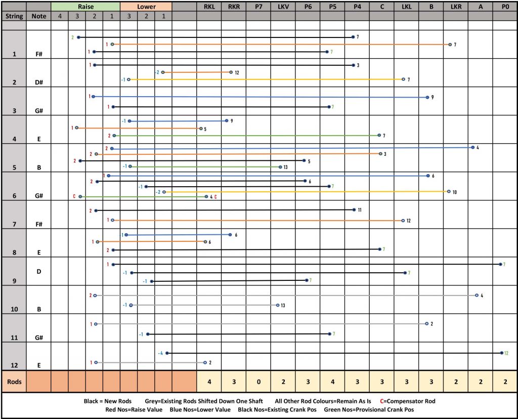

So here is what I reckon is going to be the final copedent and rodding chart I will be working from with the additional change/rod on pedal 6, for anyone interested in the detail. (There's bound to be one in addition to Calum) :lol:

I got all the rods in position last week, since then I have been trying it out and am continuing to make changes and adjustments. I had suspected that I already had most of the changes that I had assigned to pedal 5, this is the pedal which lowers the G#'s to G to give the minor, i.e. on open, no bar - E minor. I was already mostly doing this on a split with the B pedal and LKR, the exception being the low G# now on string 11. So to simplify things I removed pedal 5 and will put an additional rod on LKR to lower the low G# a tone, in conjunction with the semi-tone raise on the B pedal the resulting note is G, so the result is exactly the same notes as I was getting from P5.
I left the space between P4 and P6 which makes it easier to hit P4 and P6 without getting snarled on P5.
P0 sounds brilliant, combining this with the A pedal and the F raise offers many possibilities. It's really just an expansion of the AF combination. P0 takes string 12 down to C#, tuning the P0 / F lever split so the F has no effect when P0 is depressed maintains C# as the root. P0 in combination with the A pedal gives a C# minor, when you bring in the F lever it gives a C# major on the higher strings maintaining the C# as the root on string 12. P0 on it's own is almost DADGAD a like.
Just a few things to do then it's a case of tuning in the action on the pedals and levers to give the best action. I removed the E to F# raise on string 8 on pedal C, I didn't really see the point of it as F# is already there on string 7, instead I lowered string 12 to D on the C pedal, a suggestion from Calum, this works nice, I haven't explored this change much so far. I also changed the F# to G# raise on string 7 on P4 to a F# to E lower on string 7 on P4. This is the same as I originally did on this change combination when I had it on P0, I thought I'd try it as a raise rather than a lower but I prefer the lower. Might try doing something with the D on this pedal to give the the whole major chord across all 12 strings as I originally had when it was set up Universal.
