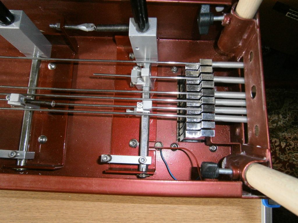

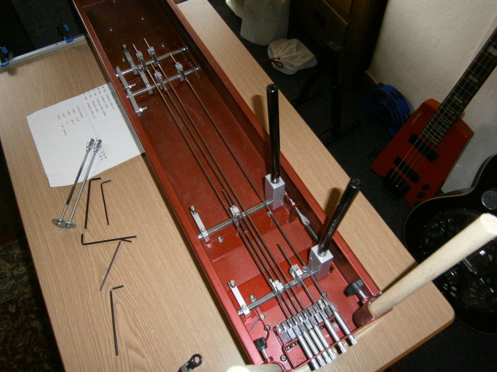

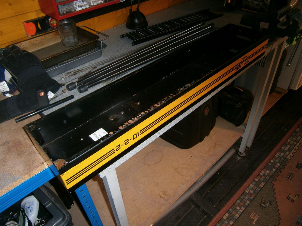

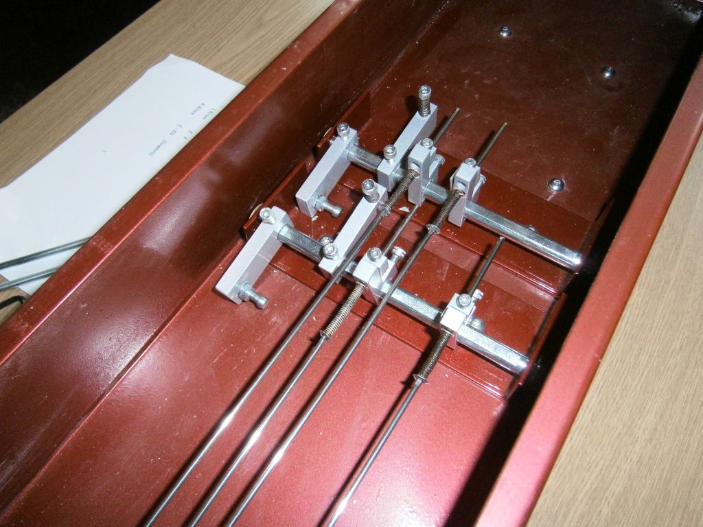

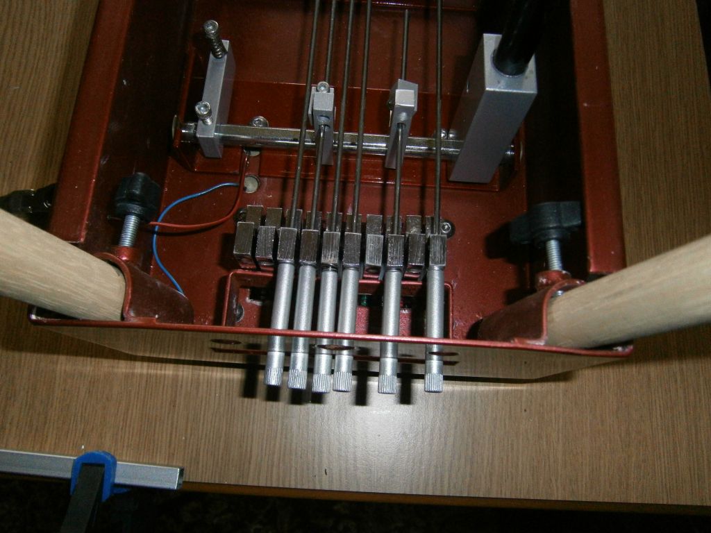

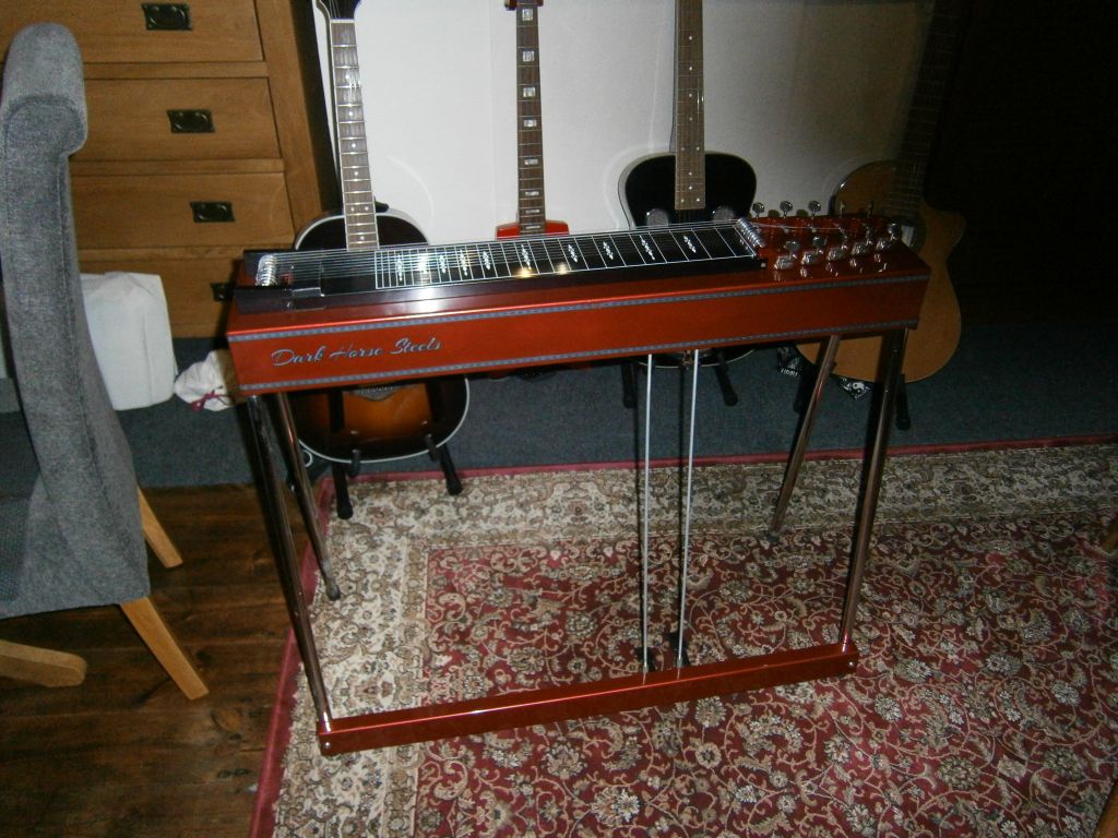

What do you make of this? Here's what I know...made by Hall Manufacturing, Dorset; all the fittings are imperial, so that dates it at around 1970. The body is unusual, being 16ga steel; there are some nice engineering touches, Schaller machine heads...other than that, it's an enigma. I bought it 2 years ago as a rusted basket case (see photo), and refurbished it. I asked Gerry Hogan about it; he had met the designer/engineer way back, but suggested I scrap it and buy a 'proper steel'.
I've set it up the way I found it, but the pedal linkages are wrong - pedal 1 does what pedal 2 should, and vice versa. The right hand knee lever has a spring return, but the rest of it has me baffled. I'd like an Emmons set-up, but apart from getting the pedals sorted, I'm lost. Does anyone have any ideas? Is the world my oyster, or my lobster?
Try as I might, I can't get inside the designer's head, particularly the knee lever set up. I can't see how lowering strings can be achieved with what you see in the photos. Any info/input will be greatly appreciated.

At first glance at your photos it looks like the changer on string 8 just needs to have some preload from the knee lever rod, matched against string tension, so that dropping the preload on the knee lever (i.e. by activating it) will allow the changer to rotate under string tension until it hits the stop. It looks like the RKL knee lever should raise the 4th string, whereas RKR should lower it. But it's a bit hard to see - is there any chance you could make a short video showing what happens at the changer end when the various pedals and knee levers are operated please? Or describe what SHOULD be happening on each string when pedals/knee levers are operated? Most importantly, do any strings need to be pulled by the pedal and also pushed by a knee lever?

The interesting part was on string 4, where the pedal rod connects to the changer at an upper position (closer to the centre of rotation), and the knee lever rod connects to the same changer at the lower position. The changers all have two pins, presumably for whole tone or half tone movements, based on a given length of rod travel... I could really do with some adjustment on the crank of the C pedal, as I've had to leave a bit of slack and there is only just enough room to get 2 semitones of raise, and one semitone of lower. But it does the job for now... Ebay beckons for the Denley though, as soon as I've saved a bit more cash for a more modern beast :lol:

Your issues and comments are very useful, and have opened several new windows worth exploring which I'd overlooked; my changers have two holes, as have the bell cranks. Interesting.

Hi again Jonny, after some deliberation and a rather large helping of tenacity (it's in my DNA, I've learned to just accept it...) I think I now understand the design intent of your steel guitar.
It looks like the pedals will work exactly as A and B normally would, ie raising both G#s to As, and both Bs to C#s. That should be simple enough with the setup as per the photos. The knee kevers are much more exciting though! I think RKR should drop the Es to D#s, but RKL looks like it should raise the higher E to F. You could probably get that to work on both E strings if you could be bothered - either way this would give you the Db major chord with open strings (Bs raised to Dbs with pedal, Es raised to Fs with knee lever). I can't do that on mine. Yet...!
I should point out that I know less than nothing about steel guitars, but I would suggest getting the RKR working to lower the Es first - a bit of preload on the rod should pull the changer away from the stop against string tension, then operating the lever will allow string tension to pull the changer until it hits the stop.
