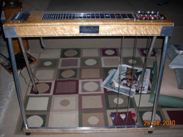

Anyone know if the original Maverick was made without Knee levers and if so was it possible to add KLs? Also what was the pedal set-up and could it be changed? Thanks in anticipation for any help on this.

Trying to trawl through my memory bank, I am pretty sure that the Mavericks originally came in 3 + 1 format with the lever positioned at RKR. The changer didn't facilitate multi pulls on the same string, so the lever typically would lower string 2 to D or the bottom E string to Eb. When I was a rep for Sho~Bud (London) selling their guitars, I would try to steer potential customers away from the Maverick because of its very limited pull mechanism. However, it was cheap and cheerful at the time and had a half decent tone. The natural wood model looked quite pretty too.
Years ago, the late John Coop in the USA built a replacement changer for the Maverick which allowed a 3 + 4 set up. I never saw a close up of that changer, despite asking John by email if I could take a peek at it. So, it is not beyond the ability of those with a technically adept mind to design a modified changer for the Maverick that would allow for modern pulls to be installed. If you click on this link http://bb.steelguitarforum.com/viewtopi ... k&start=25 you will find a few pics on a modded Maverick that now has 4 levers.

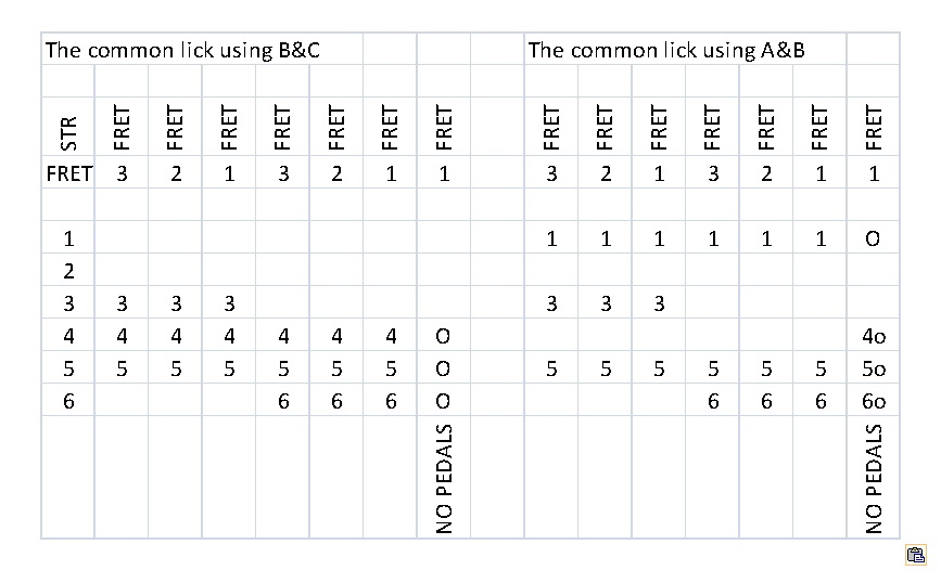

Postby bob adams » Mon Jul 17, 2017 11:32 pm
Mavericks as with other single finger guitars are built to raise or lower but ideally not both!
Feel free to spend many hours trying to assemble springs to balance Eb to F on the 4th and 8th!
Trust me I should be bald by now!
This guitar was based on a convoluted tuning to achieve the chords but for modern shapes and learning it could be challenging and then when you have learned it you have to do it all over again on today's setup.
So: on a three lever setup:
on a right moving lever lower 4th & 8th [works] ..............Just lost your C pedal change? ...........let's come back to that!
on another right moving lever lower 2nd and 9th [works]
on a left moving lever raise the 7th [works]
to give your C pedal something to do you could raise your 1st! [works]
On a two lever setup lose the 7th raise
So for those B&C pedal changes! Try this on any standard E9th setup
The attached is not tab as you know it but I hope it makes sense!............The last bit means 456 open!
Identical notes are they not???!
It is all about what we are used to and comes back to the age old statement !!
I play it this way because that's the way I learned it when I got it!!
