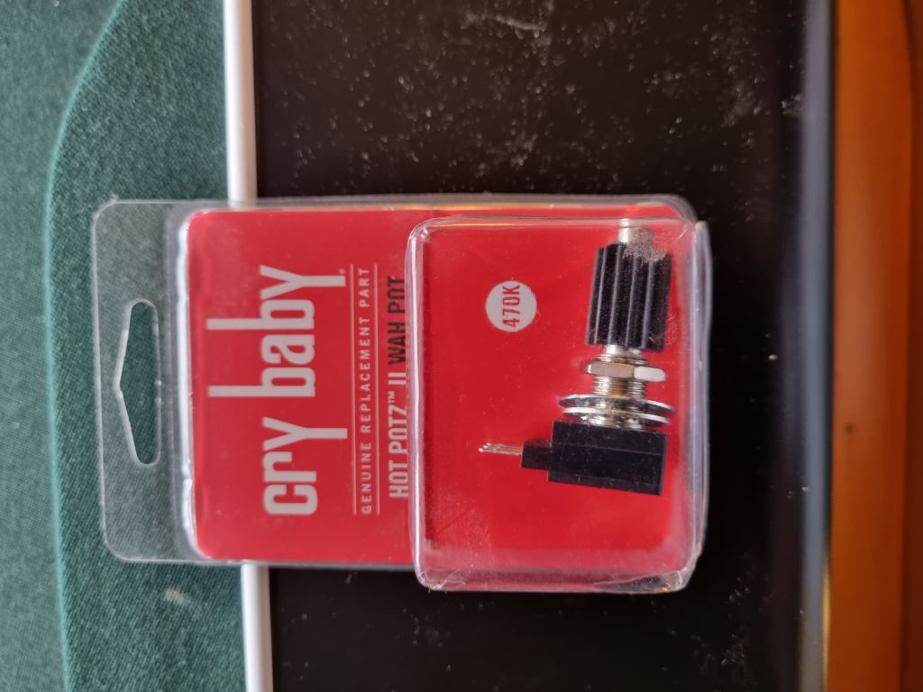

Postby JohnDavisStringsHere » Sun May 17, 2026 2:45 pm
for those that know electrics........... would this be any use for volume?..... apart from that all i have is some pots for the basic carter volume pedal allthough they are new they dont look quality
Posts: 6246
Re: Replacement pot for Goodrich volume pedal
Postby Malcolm » Sun May 17, 2026 2:58 pm
Yep John that is newer style Dunlop 470 Hot Potz , as Derek said you have to remove the black plastic gear to fit it in Goodrich or similar type pedal.
