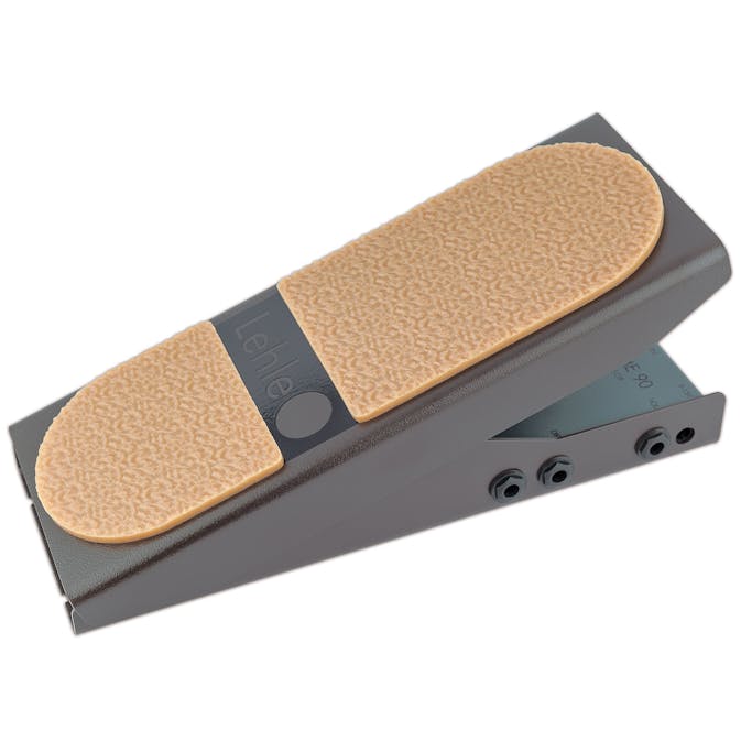

Postby Ted Nesbitt » Sun May 19, 2024 1:58 pm
Does any of you players out there use a Lehle volume pedal? They make a side loading pedal ideal for pedal steel. Would love to hear any comments from anyone who has one.

Hi Ted, I bought one last year, the side loading version, Lehle Mono Volume 90, I also bought the bracket which has a swivel option. I love it, to me it has a very smooth natural response. It's a good bit cheaper than the more well known brands and to me every bit as good.
When I first got it my friend Calum McLean, (Haddock on this site), brought over a Telonics pedal and a Hilton Pedal, we compared them and of course the Telonics is an exceptional pedal with many options, but to be honest I thought the Lehle was just as responsive, less options of course but if I remember correctly once Calum had found the settings he liked he stuck with them. I preferred the Lehle to the Hilton, though this too is a good pedal. I also have a Goodrich L120 which I like but prefer the response from the Lehle.

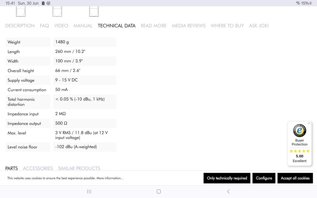

Just bought the Lehle Mono 90, but really hot and shrill signal even when adjusting the pickup height..
Seen on the other forum there's a mismatch between the impedances of the PU and pedal
Did anyone else have the same issue? How did you overcome it?

Hi Geosteel, can't say I've encountered the problems you are having. I've attached a picture below which shows the specs of the pedal, the input impedance is 2m ohms, that seems to me like a good match for the pickup impedance where the high impedance is not loading the pickup.
I do have a high impedance input buffer cct built into my steel but I can switch it in and out, with it in the tone is a bit brighter than bypassing but never had any problems with either setting.

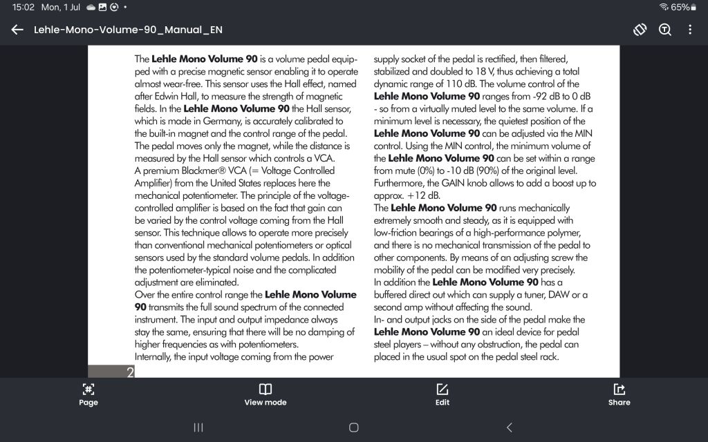

Just checked out the manual. Here is a description of how the volume pot can be used to reduce the preamp gain. Perhaps adjusting this to reduce the input level would work to un-heat your response.

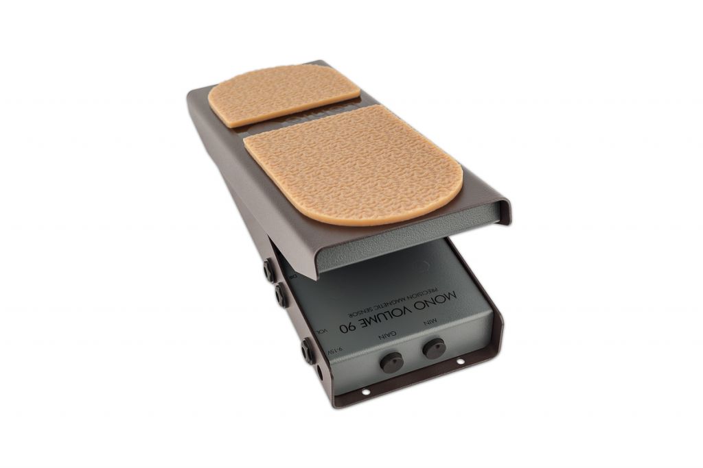

As you can see in the picture below and on your own pedal, there are 2 pots on the front, the one on the left adjusts the overall volume response, reducing the gain should help, perhaps your signal from your pickup is overloading the preamp in the pedal.
