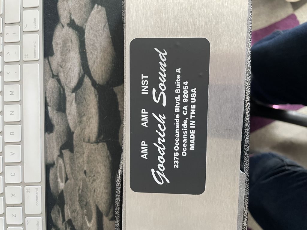

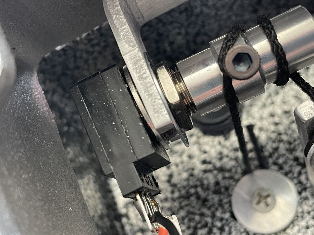

Postby SoBSteel » Tue Apr 30, 2024 11:24 am
Insides
Label
Photos attached of the pedal

Hi Shaun, looking at the pictures, that's definitely a pot, just a different shape. It looks like it might be an Alps, (manufacturer), pot. Not sure if that will be the original pot or if someone has put in a replacement. I'm afraid I haven't seen enough different versions of that pedal to make a judgement. I do have a Goodrich pedal, the original pot in it was the silver round type but they may have used different types in different generations of their pedals. Perhaps someone here who has more experience of them could verify that.

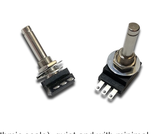

Postby Malcolm » Sun May 12, 2024 10:13 am
Shaun, looks like a Tom Bradshaw 470 pot may have been fitted.Check out Tom Bradshaw steel guitar, they are listed on his site, Tom was the guy who brought the Dunlop Hot Potz 470k to the notice of steel players, fitted one to my old Goodrich many years back now after having run through all the replacements available eg Allen Bradley, PEC, Claristat, all were total crap, some only lasted a month best I got was six months., Tom’s pot is still going strong.

Postby Malcolm » Sun May 12, 2024 10:17 am
Tom Bradshaw type J 470k pot.
