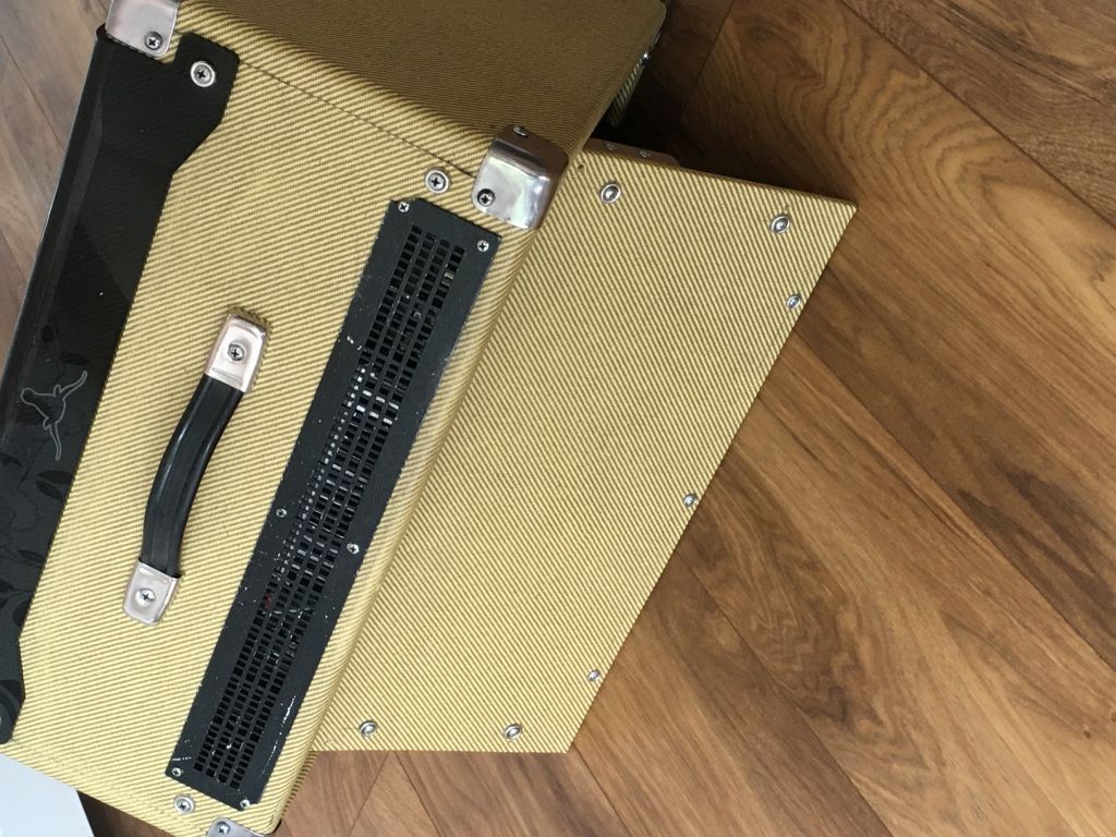

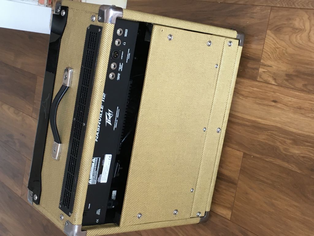

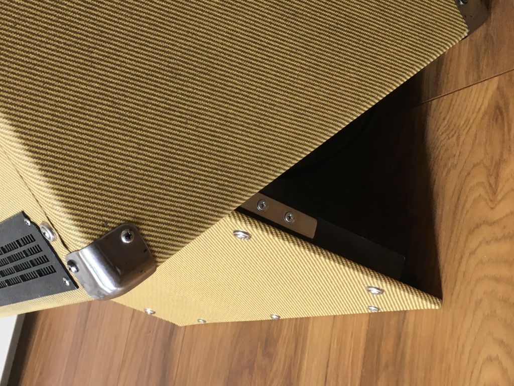

So...like most of us just nowI have time on my hands. I'm always trying to minimise set up time and carrying extra gear so came up with this. I made a new back for my Nashville and fitted it with pivot hinges so now I have one less stand to carry. Yay!!! Stay safe

Ooz A clever boy then......? Good job.
Posts: 6250
Re: Lockdown handiwork
Postby Malcolm » Sat May 23, 2020 4:54 pm
Excellent idea Derek, now looking at my cabs to see if I can do it..
Posts: 1800
Postby Dave Nutt » Sat May 23, 2020 8:16 pm
Nice job and a great innovation, well done Derek.

Grand Job, Derek!! Amps should come with a hinged back panel as standard - certainly a more elegant solution that the additional stand or the Fender 'tilt-back' legs, in my opinion.

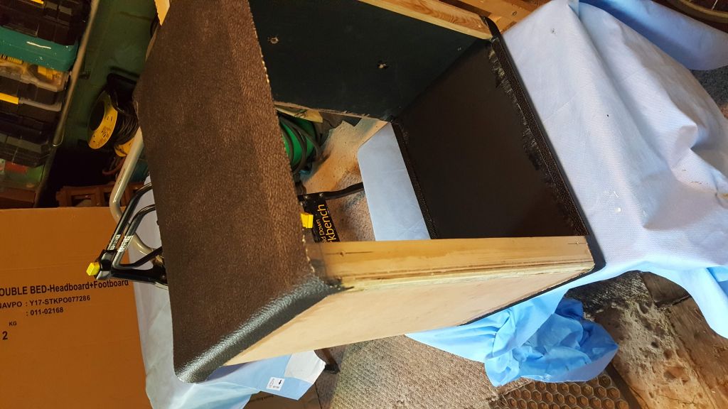

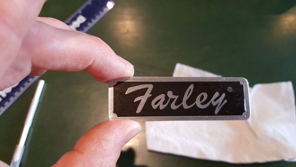

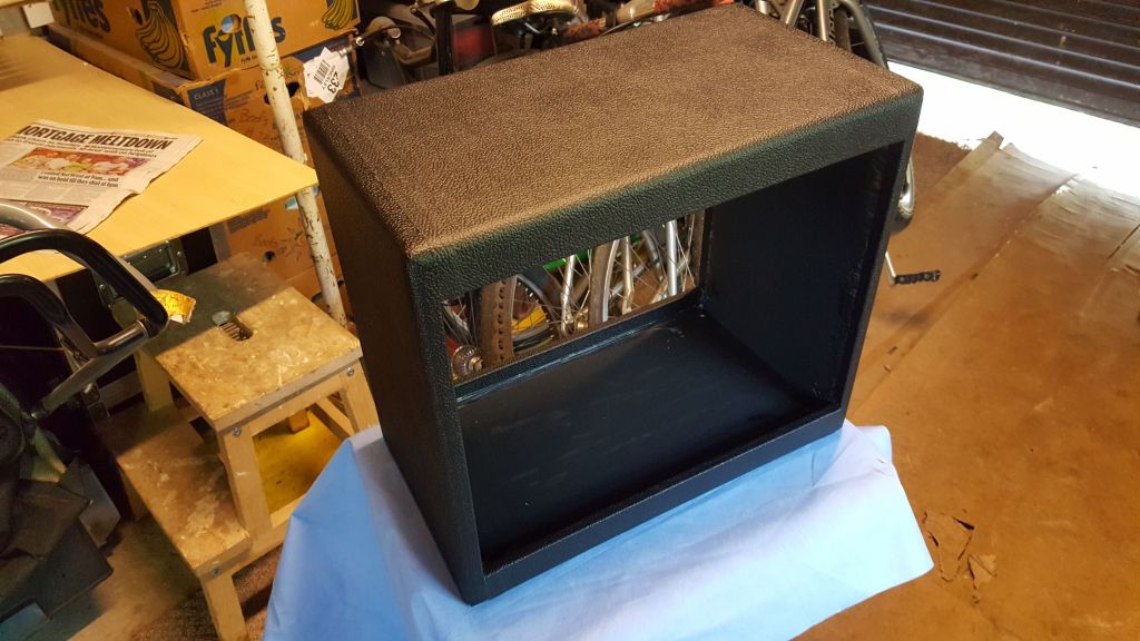

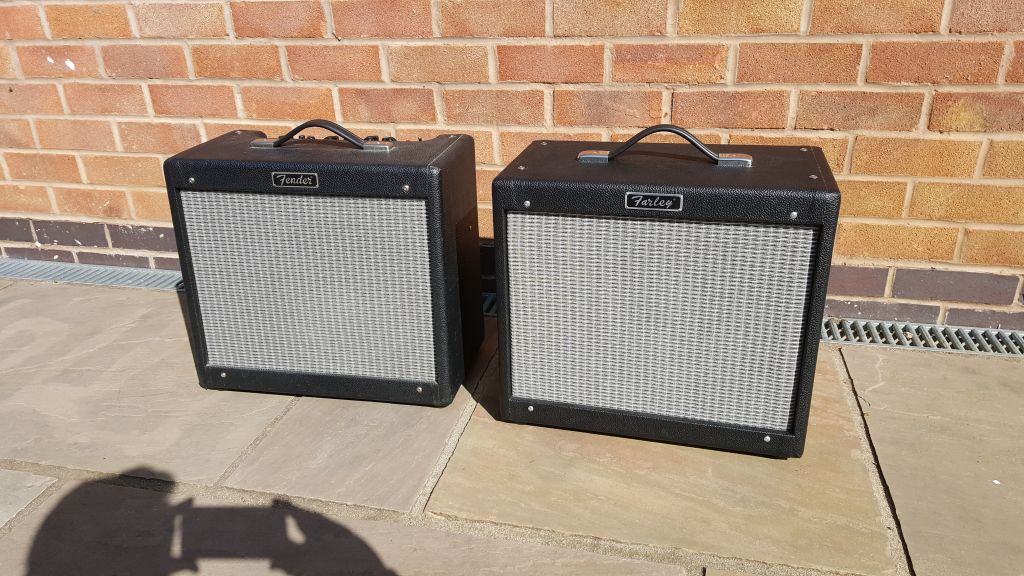

I spent a bit of time in the lockdown making a few mods to my Blues Jr, and then making an extension speaker cabinet for the same. And then I decided the speaker may as well have an amplifier put into it, as I had one without a cabinet... So I ended up making a chassis... And then I figured it needed a badge, so with the help of Powerpoint, a bit of CAD software, some waterslide decal paper, and a can of acrylic lacquer, an acceptable artifact was created! And then I thought I would use a nice Paisley patttern for the faceplate, just because I could :D

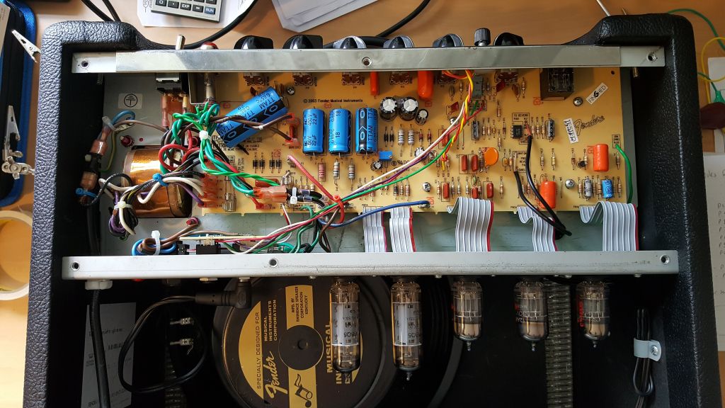

The Blues Jr had a tune-up to include the following:
  • Bigger power stiffening capacitor
  • 'Blackface' tone control modification
  • Tone capacitors upgraded to Sprague Orange Drops with increased capacitance
  • Bias trimpot installed to get the valves running at a sensible temperature!
  • Jewel light fitted - this was a massive pain in the a$$ and required the rotation of the main power capacitor, but well worth it as any Fender amp with a plastic LED just looks so wrong!
  • Presence control fitted
  • Small capacitor added on negative feedback circuit to prevent high frequency oscillation
  • External speaker jack inserted into the undercarriage
  • New valves
I have to say, it feels a lot more like a bigger amp now. Looking forward to being able to take it out and properly test it in a gig situation!
My home-made badge!
Completed modified circuit board

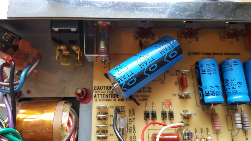

Main power cap had to be rotated to get the jewel light in. 6V supply came from the valve heaters.

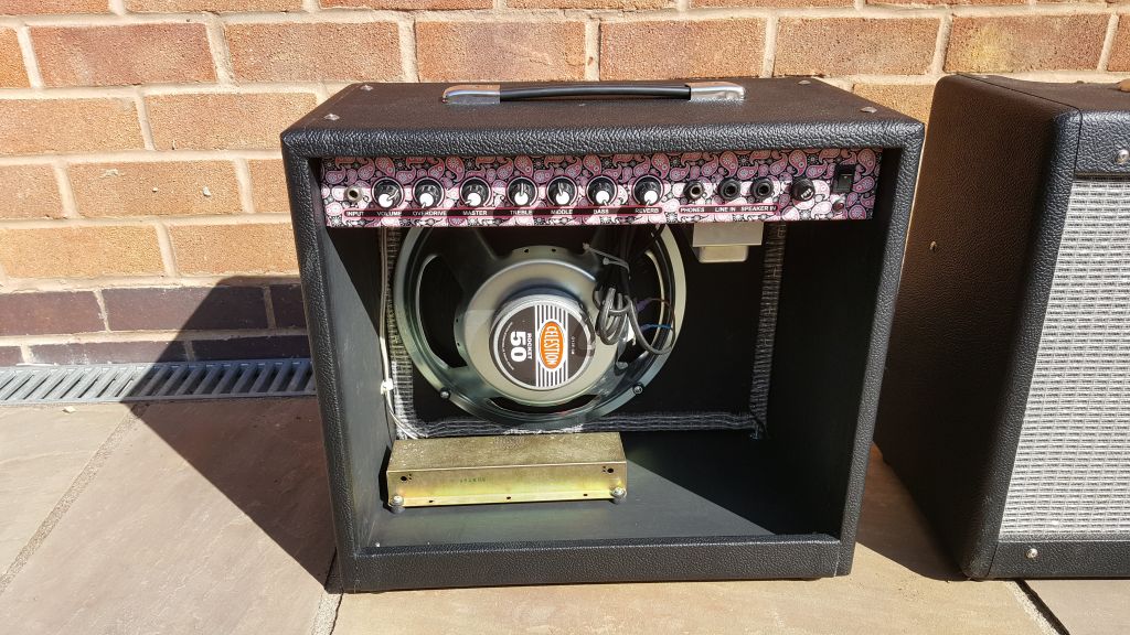

The 'hidden' amplifier inside the extension speaker cabinet

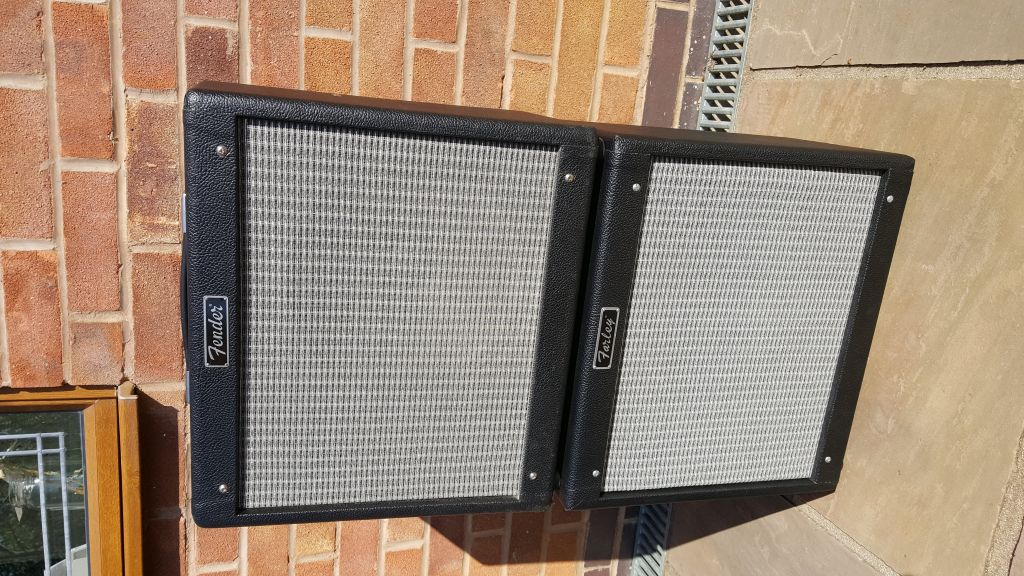

Original amp on top of the extension speaker

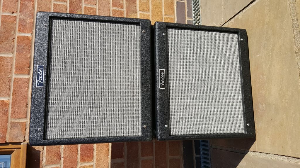

Side by side - extension speaker does not have the angled front
The tolex covering was a pain, but the results were pretty good
More tolexing
