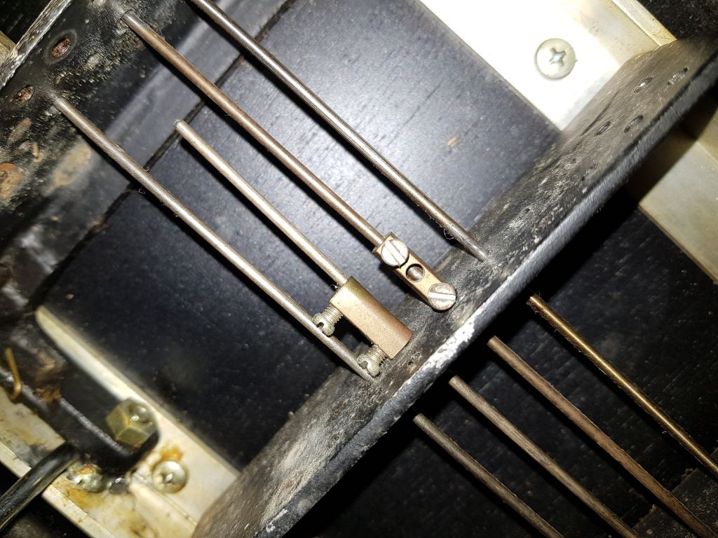

Postby cattlegrid_79 » Thu Feb 27, 2020 10:21 pm
Hi all
I've just dragged my old steel out of the cupboard for the first time in years. I have a couple of clamps missing for the push pull rods. Anyone know where I can get some more? Pic attached (hopefully)

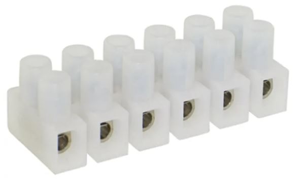

They look like they came out of electrical connector choc blocks. Iv'e seen these inserts used before, for this application.
Find one or two that fits your rods & remove the screws & push out the connector, and there you have it :D

Nice one. I didn't think of that, but yes, they do look spookily similar. Thanks!

Not very nice to look at for under a steel, if its standard 3mm rod PM full name and address and I will post you some "Emmons type" locks
