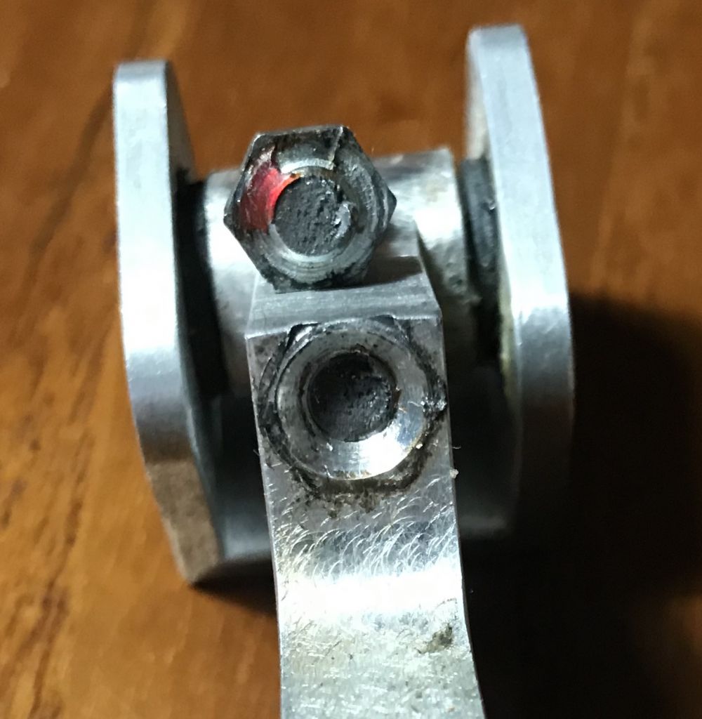

Hi all
I was happily playing away last night giving it laldy on Satie’s Gynmopedie no.1 when a sickening snap occurred down below and my B pedal went all floppy. I had snapped the stud that attaches the pedal rod to the pedal and fortunately I have spare pedals so it was an easy fix. If this happened on a gig though, I would think most folks would be unlikely to have a spare so you’d be screwed. Closer investigation revealed that the hole for the stud is heavily countersunk to the extent that the hex part of the stud barely has any metal at all to mate with. It’s been flexing slightly and over time has snapped. I’m going to shave a couple of mm off each pedal to remove most of the countersink and I think it’s unlikely to happen again but it might be worth having a look at your own if you have one of these guitars. Pic attached.
Calum

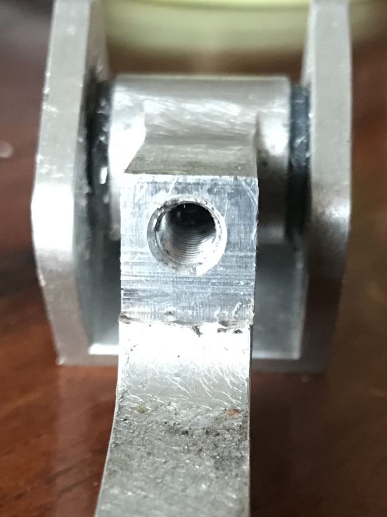

Postby Haddock » Fri Jan 25, 2019 10:09 am
Here’s a modified one. It needs a very small bit of countersink left to accommodate the slight raise where the stud thread ends but you can see there is loads more metal to meet the hex bit now. Worth doing I think.

Postby Haddock » Fri Feb 08, 2019 8:22 am
Hi Malcolm
Yes I reckon this could well be a very rare occurrence. Perhaps a 1 in 10000 fault? But you can see that the hex has been digging in to the pedal and started to move. This is an older legend and I’m the third owner so its been wiggling for a while and might have lasted many more years. Still, I’m happier now that Ive tweaked the rest and I know which type I would want as a clutch pedal on my space shuttle! :lol:
