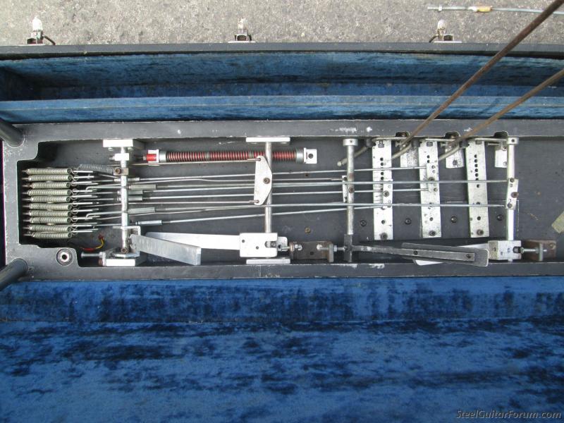

Postby Tony Russell Davis » Sun Nov 13, 2016 10:54 am
http://bb.steelguitarforum.com/userpix1504/2419_vMEaUD4_1.jpg
This should be a link (if I got it right) to Richard's old ZB student. I posted it because that's what a ZB should look like underneath and not neat like the guitar Ron made. ZBs are "different" to most all-pull guitars and don't have to be tidy with parallel rods etc. Admittedly Richard added some extra bits and bobs, but the basics of the guitar are clear.

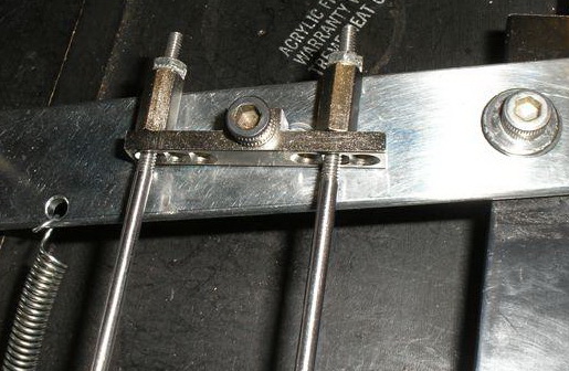

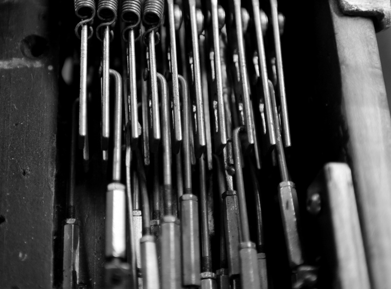

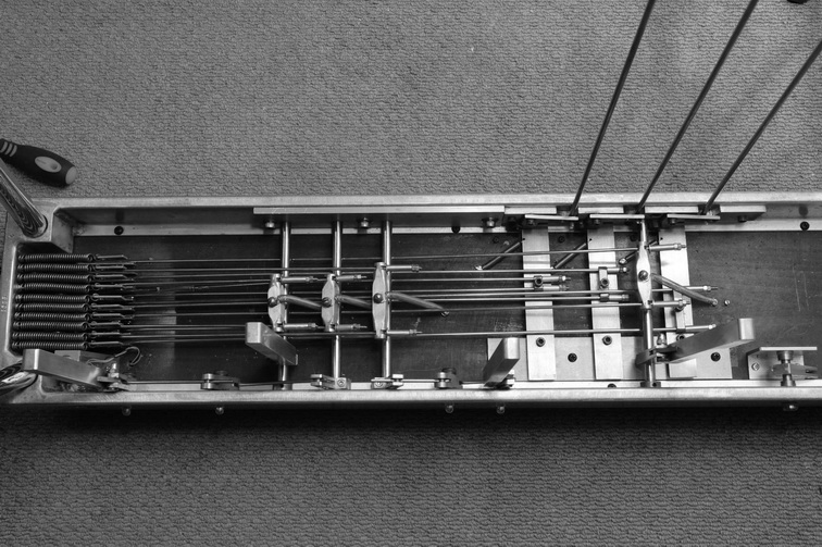

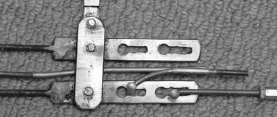

Postby bob adams » Mon Nov 14, 2016 12:40 am
Since Malc threw my name in here ....... this is my twopence worth!
The wonderful ZB
Undoubtedly another tone machine of the seventies whose undercarriages have perplexed many and countless have set about modification.
I guess it depends on what you want from the guitar,do you want soft and lengthy pedal and lever action or the definition you would demand on a modern players guitar.
For me the choice is the tone with more precise action and pedal /lever stops.
My preference is direct pull rods with adjustment at the yoke (or cross-shaft) with the single exception of the half pull on the' F' Lever, Why? The adjusting turnbuckles (the left/right threaded hexbar) are often bunched near the changer and foul against each other, removing them creates much more precise and free pull action.
My thoughts in pics below:
1: Those Clapham Junction turnbuckles
2: Revised style crossbar yoke
3: The half stop pull, the one to retain (purely for the convenience of using the brazed jointed rod)
4: A ZB student undercarriage with very clean playing action.
NB: When I received this guitar some well engineered work had already been done by one of our renowned techs however there remained fouling problems which the rod changes and a little additional engineering sorted out!
Regardless of this contribution I can say hand on heart that I consider Richard as a seriously sweet ZB player with an outstanding sound I could listen to for hours.
His setup is ..... 'how he likes it'....... The above setup is .... 'how I like it'
I guess life would be dull if we all thought the same!
