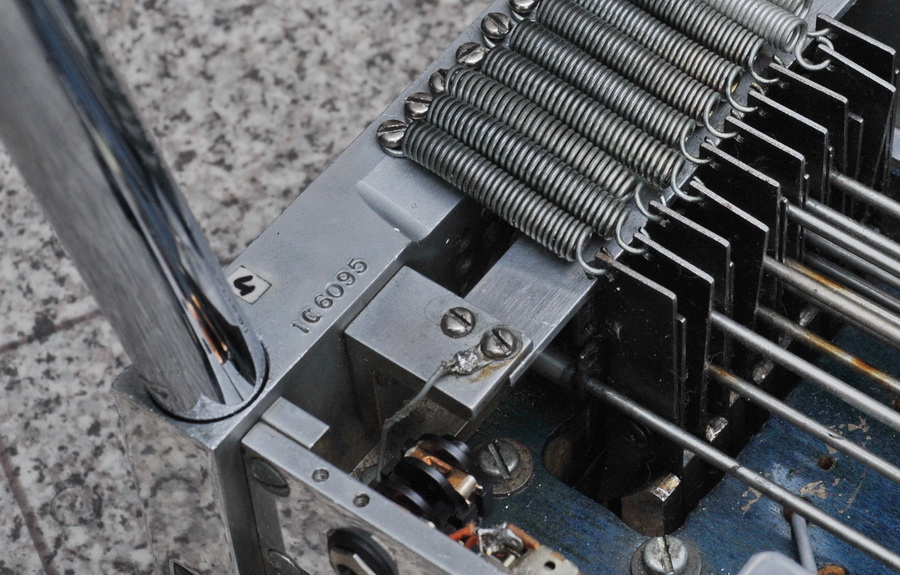

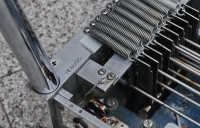

This won't eliminate your noise but it will help...
This was on a classic !

Re: Earthing issue with MSA classic super sustain 12 string
Postby Phil_M » Mon Jun 06, 2016 8:32 pm
Great thanks!
Where is this grey wire coming from? I only have this set up. I have a tone and volume pot but I just rewired it how it was with the single coil, no idea if that was correct or not :/

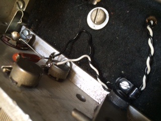

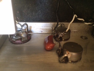

Postby Phil_M » Mon Jun 06, 2016 8:35 pm
Here is a close up
Postby bob adams » Tue Jun 07, 2016 12:25 am
The earth side of your wiring! White should be hot so I assume black will be the one!
Posts: 1725
Postby Phil_M » Tue Jun 07, 2016 5:12 am
Haha ok, so leave the white one where it is and solder the black one to the underside of the changer like in your picture?
