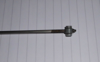

I wonder if anyone has any of these? It's the little nylon barrel thing that I need (6 actually), not the rod. It sits in the bell-crank of a Sierra and the pull-rod screws into it for tuning. I can make all the other additional knee-lever parts, but every time I try to turn some nylon rod down to the right size for those "shoulders", it distorts in the lathe chuck; and I've tried several sorts of tool including sharp wood chisels. Any advice gratefully received. Tony.

Just a little guess here, Tony, what is the diameter of the nylon part at those shoulders? Not the bit the pullrod goes through, that has a greater diameter, but the shoulder itself? If it's 1/4" I have a hollow mill that should make forming that shoulder a breeze.

Will you are exactly right, it is 1/4in dia. and the "greater" part is 3/16in across from "shoulder to shoulder" (the "greater" dia. of that broader part is not critical but it seems to be 3/16 too). I know of Jim P. but wondered if there were any in UK before asking over the pond. Cheers, Tony.

Tony, they are rarer than hen's teeth, I just got lucky, got mine on eBay from a guy in Canada (eh?) and it has made it so easy to form the machined ends of cross-shafts. It cuts axially, not radially, which would be why the nylon stock wouldn't deform in the same way - hence my suggestion. Pardon me for checking, but isn't 1/4" greater than 3/16"? I may have misunderstood you there somewhere.

Will - oops - thanks for the correction; that's me struggling with fractional maths :oops: . 3/8ths is the correct size! Why can't these things be in metric where a bigger size is a higher number? Simples!
