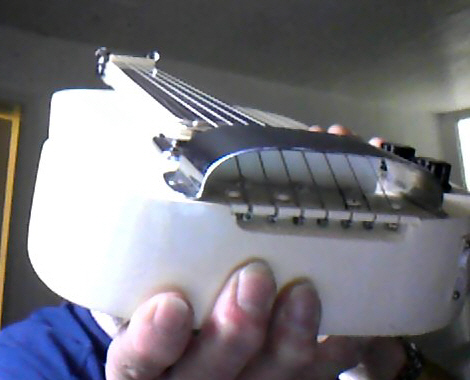

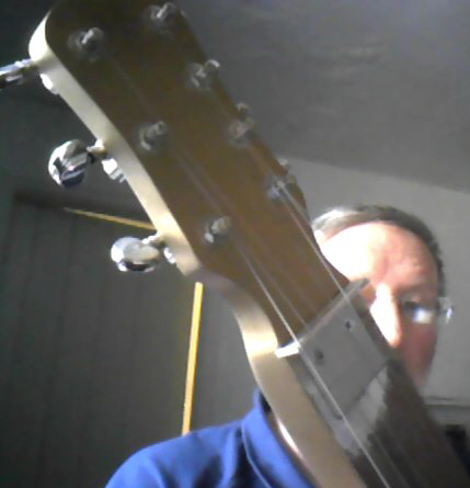

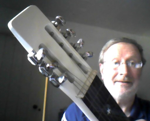

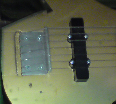

The pics are of 1. a bridge sunk into the body; 2. the head of the guitar showing the angle ali, nut mentioned later, (it could have simply gone from side to side and painted over - I was being "clever" by routing it inside the edges :roll:

The bridge and nut can be made out of angle metal (ali, brass, steel ....) using a hacksaw and files. You used to be able to get ali offcuts from those guys that make window frames. I got loads of stuff from one; angle as above, narrow channel for PSG knee levers, wider channel for knee lever mountings and also for lap steel bridges*. All free as they were too short for him to be bothered and not heavy enough to weigh in.
The bridge needs suitable "nicks" (for the string ball-ends) in the edge of the part that sits on the guitar top and you might need also to rout a grove in the body for them (like in the gold-top pic).
If using *ali channel, you can drill holes for the strings in the back edge (cut it down from the height of the front "bridge" part). That type can be screwed straight down without routing the guitar if you like.
One other tip if you use angle stuff for the nut, screw it down with the return under the fretboard rather than towards the tuners. Saves space and looks neater although you need to rout out the housing for it.

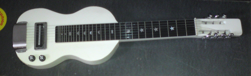

The other pics show another homemade (it doesn't matter that they're 7 stringers) and you can see the head is a simple router job after planing it back to a slight angle at the front. The other shows the bridge/tail, this time right at the end. Both pickup and bridge covers are bits of thrown-away Fender bass covers (who uses them ;) ) The fretboards are black/white/black plastic sandwich, scraped through the black top using a standard guitar as the template (starting from the first or second fret to shorten the scale) and that star position marker is a "Blick" sticky meant for kids exercise books! :o

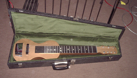

Both of them started with a planed plank of mahogany, off cuts from a timber merchant's yard but long and wide enough to take the machine head, pu/p and tail arrangement, and the body shape was added as a "wing" to either side. Those were made from available stuff, I think the white one was part of a pew from a disused church, I remember getting some mahogany that way years ago. The shapes happen to be guitar-like only because I have a bandsaw and there was sufficient width of wood to cut it out. I have made an 8st. out of a plank with no frills. I've posted a pic recently to do with painting them, but I'll seek that out too.
There's two pics ofthe white one, the gold one in the homemade case, and the 8st. "plank" about 1983 (unfortunately I'm in the picture too - did I really have a belly like that :oops: putting it down to posture, much better now :D

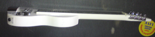

I'm having one built by a friend, 8 stringer (white sparkle), this is what it looks like right now:
