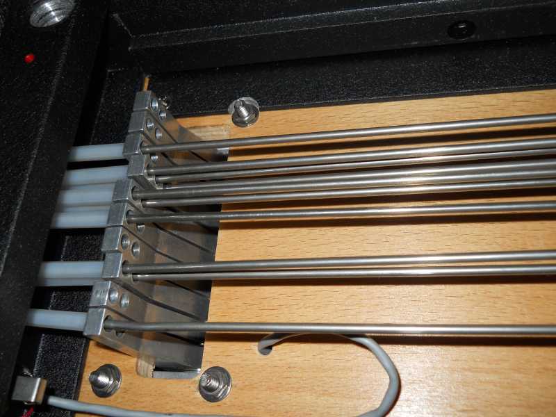

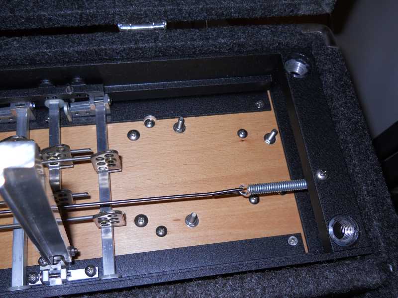

Here's a couple of pictures of an underside of a GFI student, this wasn't mine, Scott Duckworth from the US site added a 3rd lever to his GFI student and posted info about the fitting on the Steel Builders Forum,
http://steelguitarbuilder.com/forum/viewtopic.php?f=4&t=980
From memory I think a spring was required on the E lower KL but not on the E raise KL.

Like John said, you will be fine with what you have for quite a while. The other 2 KLs are nice to have but not essential and, since there is no standard placement for them anyway - better you figure where you want them before you buy.
If your books have licks that use those changes, (and mainly it's the second string lower that you will be wanting) you can increase your learning by seeking a workaround to get the note or phrase another way or in different place using your existing setup.
Tony.
Later - PS; from the pictures it is pull-release and there is room to lower the second string. It will be easier to make a RKL do that, since the lever moves in the same direction as "the release". You can have more information on the "how", if you decide to do it (involves rods and springs and bellcranks and things).
