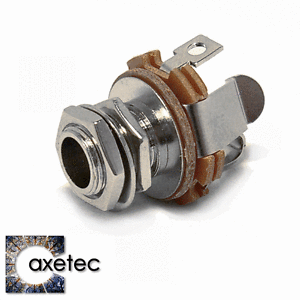

Having tested this a few times with everything taped on, the next stage is to install the two output jacks (and the piezo itself) inside the guitar. Preferably I'd like to wire the two pickups to a single stereo jack and then use a stereo-to-two-mono cable into the dual preamp. My question is about wiring. Do I wire both grounds to the sleeve lug and then each hot wire to tip and ring respectively? Also can anyone recommend a specific jack for this purpose? Would I have problems with a fancy end pin jack, bearing in mind the dobro's tailpiece?

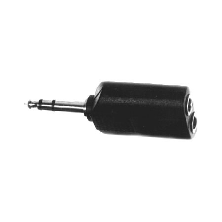

I would use a standard but heavy duty stereo socket wiring the common earths together. Also attaching an earth wire to the underneath of the cone cover. You have a choice of either using a stereo to 2 mono out adaptor (pictured), or a stereo to 2 mono Y lead. I find the former more convenient.
