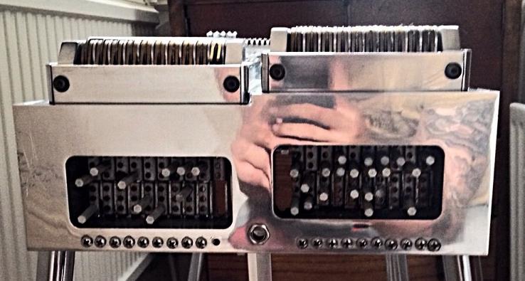

It's easier for people new to pedal steel to get a modern-type all-pull, E9 tuning, with 3 pedals and 4, maybe 5 levers.
At the changer end, get a steel with at least 3 raises and 2 lowers on each finger. the following image shows 3 up and 3 down
Things to look out for are grooves in the top of the changer fingers (where the string goes over).
Measure the string spacing at the changer, and make sure it is 11/32", and 9/32" at the roller nut.
Check the threaded sockets in the endplates (where the legs screw in), and make sure the threads are not stripped.

Postby Tony Russell Davis » Wed Aug 12, 2015 3:11 pm
Hi Peter - let's know the area where you live and we might have somebody near enough to show you a guitar close up.
John (above) usually has a houseful of guitars and can maybe even show you different mechanisms - they're not all the same.
Richard has given some good pointers too, but the photo of the end plate might not be big enough for you to see into the opening. In there are a number of plastic nuts on the ends of rods poking through some little metal plates. There should be two plates for each string, an upper that needs 3 holes in it and one just below that with (at least) 2 holes. That's what he means by 3 raises, (that's what the upper ones do) and 2 lowers (the bottom ones).
Get advice on any guitar with less than 3 pedals and 4 knee-levers. :shock: In fact, get advice anyway! Plenty help on here. :D
