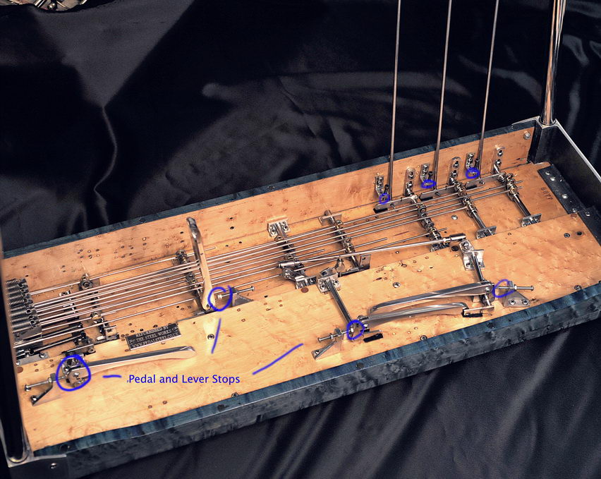

:guitar: Hi, I am sorry it took so long to get back to you been busy with the snow.My PSG is a Shobud 1,which i got from Bob Adams.You can see him playing it on you tube, A Fool Such as I.It sounds better when he plays it.I have been playing it through a Peavy Vegas.I play guitar as well,so its handy having two channels.With the guitar being a push pull,is there a specific way of tuning the E strings.Do you tune the lower first to E flat or raise to F.I have got it close, but never just right :cry: My last PSG was a Marlen which i sold on ebay,to fund the Shobud,i allways wanted a Shobud.

I doubt very much that your shobud is a push-pull.
It might be a pull-release, if it's an old shobud, but it's probably an all-pull.
If there are a load of springs at the bottom of the changer, it's an all-pull.
If it is an all-pull, tune the strings open at the keyhead, and tune the raises and lowers with the nylon tuners.

Re.Your tuning, if you are not quite reaching the pitch ease the nylon tuner until it is just making contact with the changer finger on 4 & 8 raise and lower then open up the respective stops a tad at the levers as per the photo. (an LDG pic but same difference) This action will then take your note just beyond the desired pitch (higher or lower) then adjust the nylon back to fine tune to (spot on!) A very common failing on these is users over cranking the nylon tuners, the lower ‘E’ lever then just begins to raise again! The same principal applies to the pedals always give slightly more on the undercarriage stop then go to the changer! Not the other way round. ;)
