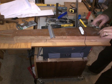

Postby flester » Sat Feb 16, 2013 10:50 pm
heres a pic of how its gone so far. The piece was not long enough so will be built from 4 seperate pieces using biscuit joints.
