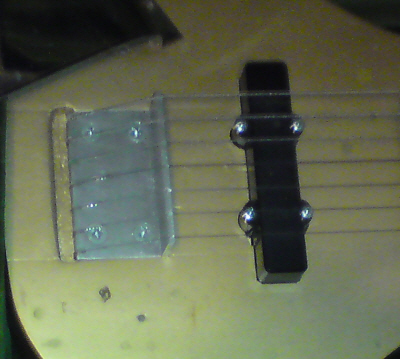

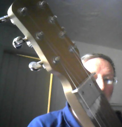

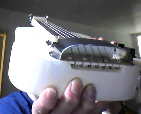

The top pic is of the tail end on a homemade. Blind slots at the back hold the ball ends of strings, and then they go over the upright which has been half-rounded on the back edge so the string goes over a curve behind and a (blunt) "knife edge" at the front. The ball-end anchors are spaced for your chosen string spacing rather than put nicks in the bridge top; the strings stay put by their tension alone. The bridge in both guitars is of angle aluminium. The nut is basically the same. The bridge cover on the white guitar is a part from a Precision bass (usually discarded by bassists). On these guitars the bridge and nut are both set in a channel routed to match the thickness of the aluminium. The angle piece for the nut "returns" underneath the fretboard to hide it, an additional channel at the back of the bridge allows room for the ball-ends (you can see that better on the white one).
