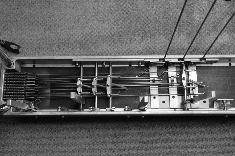

Just purchased a ZB Custom 10 string 3 + 4 after 30 years absence from playing Pedal.
Ripped it apart and rebuilding it now.
Any tips for re fitting rods back in. They were almost tied in a knot when I picked it up.
Sounds stunning - serial number 294S think it's around the 80's has Blue Plastic top, white pick up and Klusons side mounted to plastic top..

Try to balance the pulls so they bottom out together (or nearly). They might not attach at equal distances from the fulcrum (where it fixes to the cross-strap) and/or each fulcrum might not attach at it's middle to the cross-strap. The rods need not all be parallel and you could well end up with them looking very untidy - that's ok so long as they move without binding. The plastic top sounds like the ZB Student. Best of luck. :guitar:

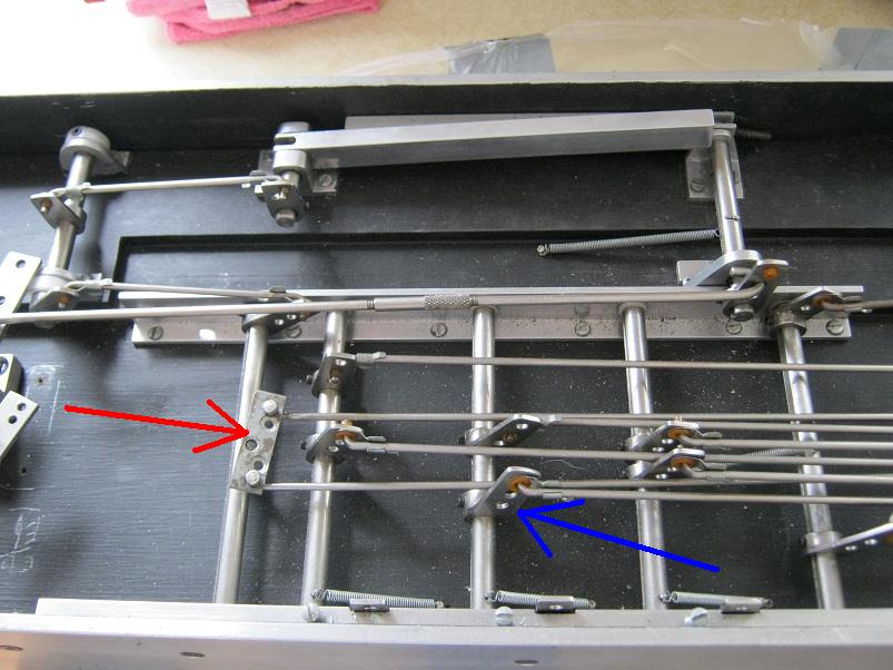

If you are pulling two strings with one lever, then a swivelling yoke (arrowed red in the photo) needs to be used on the lever cross-shaft, to ensure both tuning bolts bottom out on the endplate.
The blue arrow indicates how NOT to do it

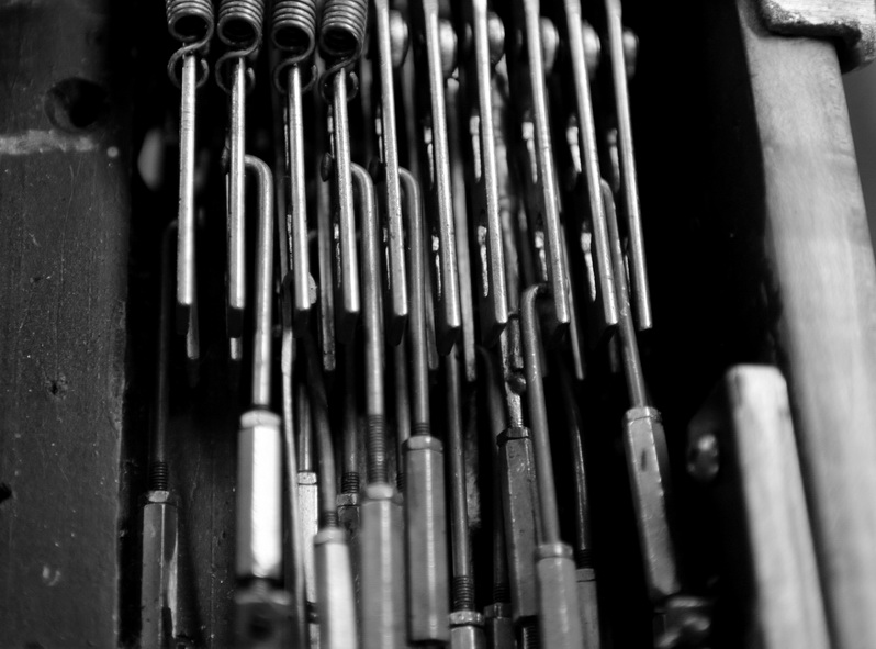

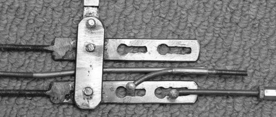

If you have a little time on your hands guys you can take the complexity of ZBs away.
They don’t have to have the flatted right angle nail head arrangement at the yoke on the crossshaft and the LH/RH turnbuckles, though they worked perfectly when set up at the factory most guitars have had tunings altered over the years and finish up with everything fouling. The easy fix is a rod with a ‘J’ at the changer end and threaded at the yoke. That will give you all the adjustment you need, straight rods and no fouling! The only exception would be the F raise for the convenience of keeping the’ middle position’ brazed joint on the pull rod.
NB: The rods are 1/8” and the threading and nuts 4BA
The pictures are self explanatory!
I did one for Donny a couple of years back the last pic was the underside when he got it back , as for the video, only the player lacked capability not the guitar
