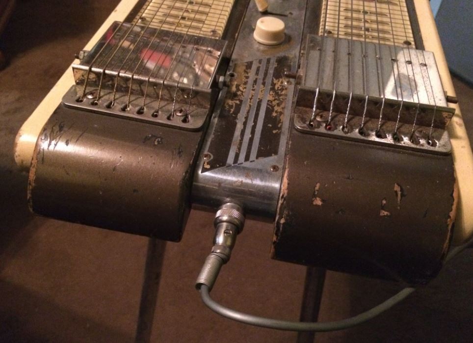

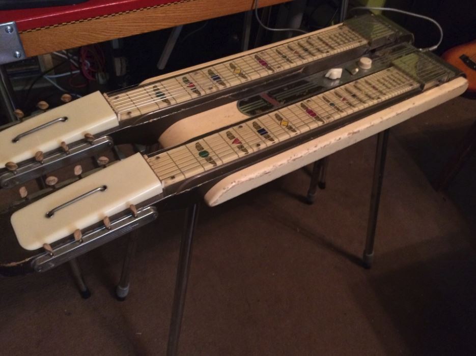

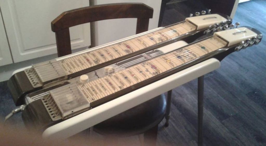

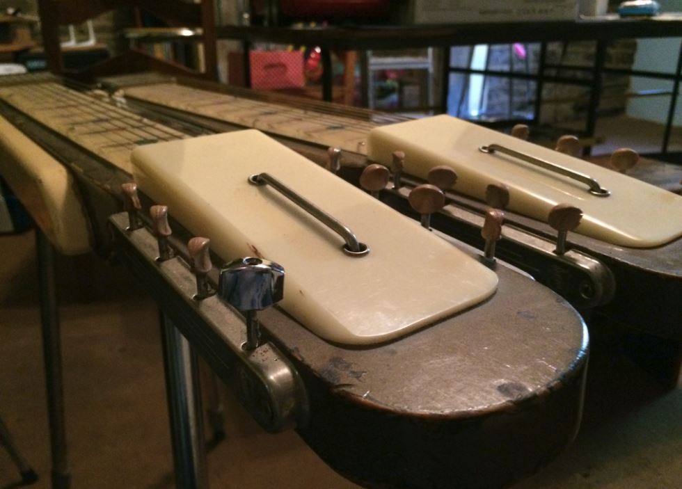

Here are a few photos of your National D8, for those who are not on 'funny book', good old steel you have there ;)
Love your sound clips by the way ! :D
