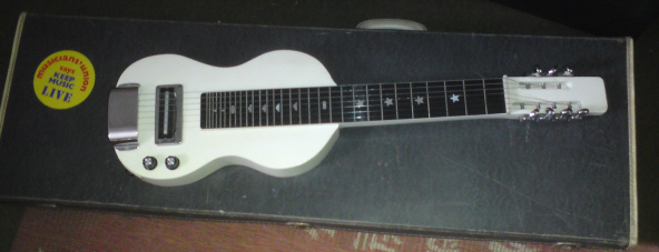

The usual and most optimum place for a single p/up is two or three inches from the bridge, so you're quite right to pop one in there. The reason is that a steel guitar can be played way higher than you normally would on a regular guitar and, because the tone changes when the bar gets nearer the p/up, we put it as far as possible from the fret-board end. How far away from the bridge is the p/up you've fitted? Your description suggests it's quite a way off the bridge and that may even rob you of some upper fret-board. :o
String spacing should be what suits you best. Many lap steel guitars have wider spacing than (for instance) Fender 8string consoles and PSGs; it can make picking and slants easier. Yours may have to be spaced to match the pickup.
Here's a "seven" I made a while ago, the bridge is just below the front of the hand-rest and the middle of the p/up is about 2.5in from it. String spacing was dictated simply by the width of the wood I had for the neck :shock: !

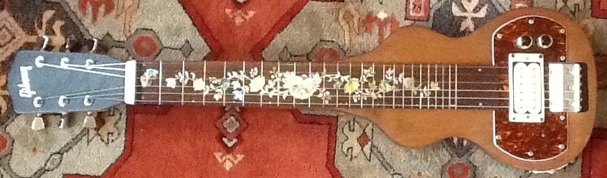

Postby WineRider » Thu Jul 28, 2016 7:33 am
Flester this is a very interesting thread. I didn't think about it when I made my three lap steels as all I did was work out where I would be picking and how to route the wiring, pots and out-put lead. But I did use without thinking (Tony and Keith) explanation about frequency of string to bar position. The killer is that all three lap steels have the pick-ups in slightly different distances from the bridge, and this came about by calculating the scale length (all three have different scale lengths). The two six string steels have humbuckers and I use on the first steel a bridge pup 6cm centre of bridge to centre of pup. On the other steel a neck pick-up is used which is 4.5cm centre to centre. On the 8 string I use a DiMarzio pup and the distance is 5.5cm from the bridge.
With my ears it isn't (to me) very noticable in difference from pup to pup, but the wood I made the steels from does give slightly different tone...the Elm one and short scale length sounds very mellow, where-as the two wild cherry ones have very similar tones although there is a difference in the scale lengths.
All this comes from 'just luck' but it seems to work.

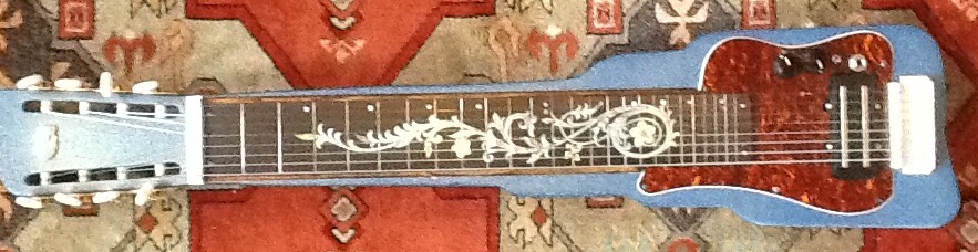

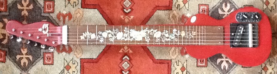

OK, here are the distances from bridge centres to pickup centres on my 3 Lap Steels.
1) Rescued 1947 Gibson BR 3 the pickup is 45mm from the bridge on a 22.5" scale.
2) Homemade 6 String the pickup is 40mm from the bridge also with a 22.5" scale.
3) Homemade 8 string the pickup is also 40mm from the bridge with a 25" scale.
When I built the 8 string, I temporarily wired the pickup to a 1/4" jack plug, then fitted a few strings and tuned them up. Next I taped a couple of wooden strips to,the guitar giving a height about 3/16" above the strings. Then I plugged the pickup into my amp and moved the upside down pickup along the wooden strips until I got the best sound/tone. And as Tony can verify, it sounds pretty good.
On the Red 6 string, I removed the saddles from the Tele bridge and installed a piece of 12mm round S/S bar.
Keith.
