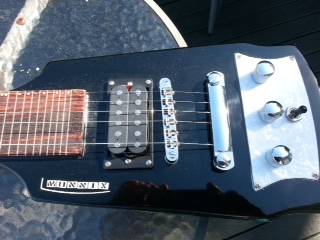

As some of my friends are aware, I'm visiting family in New Zealand for a few months. I toyed with the idea of carrying a home-build 6 string out there just to keep my hand in, but decided against it in the end. Instead I went onto the Trademe site (Their version of eBay) and bought the cheapest Lap Steel on offer. A big mistake.

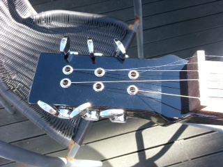

The head was the worst piece of guitar design I've EVER see. The fretboard didn't have position markers and the bridge was a rip-off angled Tune-O-Matic, complete with compensated saddles. Back to the head end. The nut was about 1" above the fretboard, then the strings went through ferrules to the tuner spindles below. The ferrules didn't even line up with the spindles. Friction, multiple angles and more friction, hence the regular string breakage when I tuned or changed tunings.

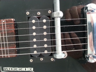

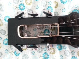

I didn't have any usable tools on hand so bought a fretsaw. After removing the tuners and ferrules I cut out most of the centre of the head, not too neatly I may add. Not having a file at hand I left it as a unique aesthetic piece of design! Chopped down the ridiculous nut and refitted the tuners. The bridge end was also problematic and there are no off the shelf parts available here. I went to the largest supplier like B&Q to get some angle or round bar, that was a laugh too. Eventually after a bit of head scratching I purchased a 10mm galvanised nut and bolt! After removing the Gibson style bridge I fitted the nut and bolt adjacent to the pickup and that gave the correct position (fret 12 X 2). The bolt head and nut gave a playable string height luckily. I couldn't shorten the bolt, but what the hell, the extra length will probably add an inch extra sustain! "Bolt-on Bridge"???
Soooo I can now begin to play again without having to continually correct the tone bar position and never actually achieving chords in tune. Oh yes, I added the fret position markers using correction fluid, again not pretty, but functional.

Here are the pictures that Keith couldn't upload. The improvements are practical rather than aesthetic, but the explanation is in the text. The priority was to get the thing playable. If Keith had access to the tools in his workshop the result would be precise and neat but can be tidied up later anyway.
He says that "the guy who designed the electrics was the only adult involved in making this guitar!"
Bolt Bridge
Fretsawed head
Original bridge
Original head
