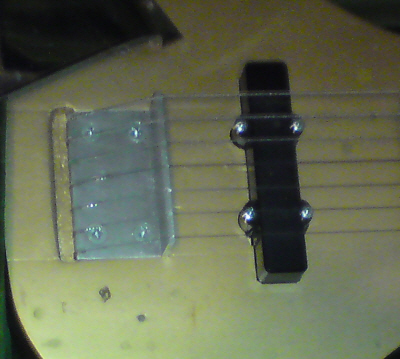

Postby Tony Russell Davis » Fri Apr 18, 2014 10:05 am
I've mentioned this guitar before (it's a 7string but there seems enough spread for 8) in connection with it's non-adjustable bridge: but here again is one of my home-builds and you can see what type of p/up is in there! :D I have a P-bass p/up too, but was going to try that in a mandolin. :o

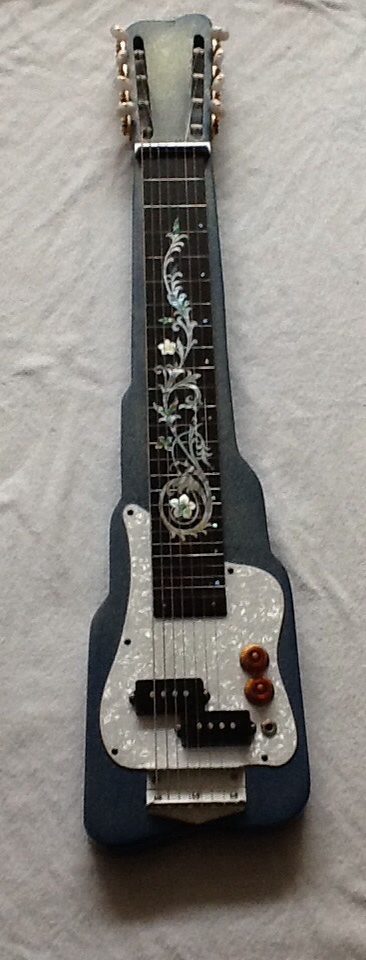

Re: Pickups? Update.
Postby nevada150 » Fri May 23, 2014 7:14 pm
I had a spare piece of "scaffold board" sitting in the garage, so I decided to go ahead with the 8 string project. It's obvious where the inspiration for the body shape comes from and the rest is just a figment of my imagination. I used the "P" type pickups that were mentioned in an earlier part of this post and also bought a "P" type bass scratch plate so that the cutouts for the pickups would be accurate. The scratchplate was cut down to suit the shape of the body. Once again I purchased a fingerboard from Bruce Wei (eBay) and also a set of 8 String tuners from a Chinese supplier.
After shaping the guitar using a fret saw,, a cross cut saw, a 45 year old Black and Decker drill with a worn out motor head bearing, a half round file and copious amounts of sandpaper (glasspaper?) I sealed it with Valspar sealer. Then I gave it about 5 coats of Valspar wood paint Denim Blue. I then covered it with a few coats of Valspar Gold Fleck and after a gentle rub down, finished it with 3 coats of Valspar sealer.
For the controls I used 2 x 250k pots with a .047mfd capacitor.
Today I assembled the guitar and tested it, using a set of La Bella C6 strings. I found the tuners to be quite tight, probably down to my ability with the Black and Decker (alignment). Tuning up to C6 was difficult and I snapped the 1st string (G), so I have decided to retune to A6, when I get another, slightly beefier 1st string (012 or 013).
The sound is good, through my little Roland 20w Cube with a bit of reverb added. When it settles down a bit and has it's full compliment of strings!, I'll attempt to post a sound clip.
Regards,
Keith.

Postby Tony Russell Davis » Fri May 23, 2014 9:45 pm
Ooooh! Like that a lot. Seems you have made a pretty, and decent spec, guitar, How do the p/ups sound and through what amp? I like C6th for the ease of finding suitable keys for my pal's voice, A6th is another useful tuning using the same intervals. My C6th has a 5th (G) on top string so it's the same intervals as A6th (many guys have the 3rd on top) so it just depends on your preference. My top string is ok for me, but that high G can sound weak. If so go to A6th, which has a beefier top. T.
