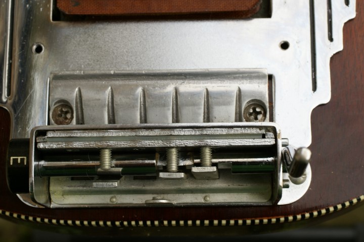

What I was really looking for information on was the Stringtone tuning changer. I had, as Barry suggested, read everything I could find online. As it happens, there isn't a great deal of info. I had asked the vendor to supply info regarding tunings. What he gave me had been cut and pasted from a forum which I had already seen. Although I knew nothing about the mechanism, I knew enough to dismiss it as nonsense. We are talking about pitch changes of 7 semitones here!!
The model I have has 3 positions : A maj Low bass - E.A.E.A.C#.E (low to high) ; Emaj - E.B.E.G#.B.E - E6/C#min7 -E.B.E.G#.C#.E. As you will observe, the 1st, 4th and 6th strings are all tuned to E and do not change. The 2nd changes by 1 tone - B to C#. The 3rd by a semitone - A to G#. The 5th by 1 tone - B to A.
The mechanism is very simple - no cams, no rollers, no friction! The 2nd, 3rd and 5th strings pass through little bars/levers which are activated by flat areas which are machined into the central lever-operated shaft. As you rotate the shaft, one or more of the flats come into play changing the string length/tension. The travel of the little bar/ levers is regulated by a set screw. Set up consists of tuning to the "home" (i.e.-unaffected) pitch, then moving to the changed pitch and fine tuning with the set screw.
I had it apart. Gave it a good clean. Back together again. (I also sprayed the pots which were a bit scratchy) New strings- I wasn't sure whether to go for custom gauges or just a set of regular 6 string guages. In the end, I decided to go light and put on a set of Ernie Ball Cobalt (Lah-di-Dah!!) Slinky. 48.38.28.18.14.11.
I tuned it up to Emaj and played for a bit. Got a wee screwdriver out and fine tuned the set screws. Bada Bing Bada Boom! It works! I had read a few reports saying how useless it was, how unstable etc. Works for me.

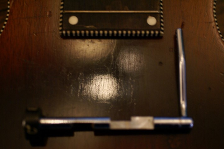

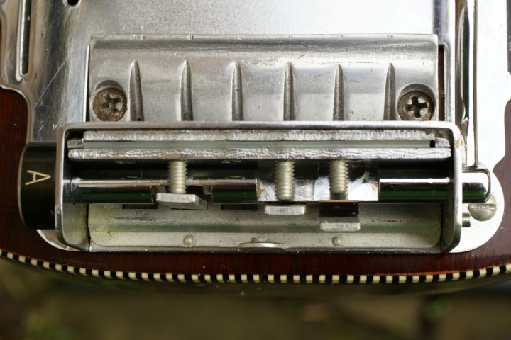

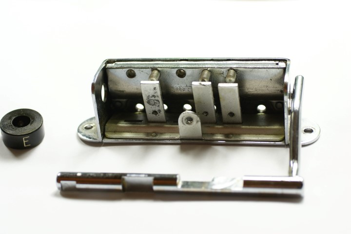

Postby michael murray » Fri Jan 25, 2013 5:05 pm
From top to bottom. the central shaft with flats machined into it.
An exploded shot of the whole assembly.
How the levers are activated by the shaft
michael murray

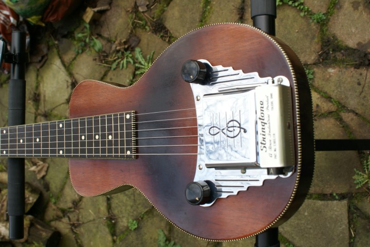

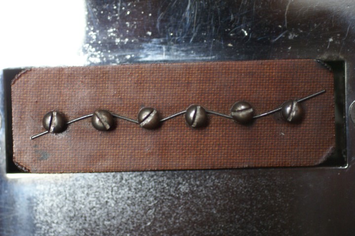

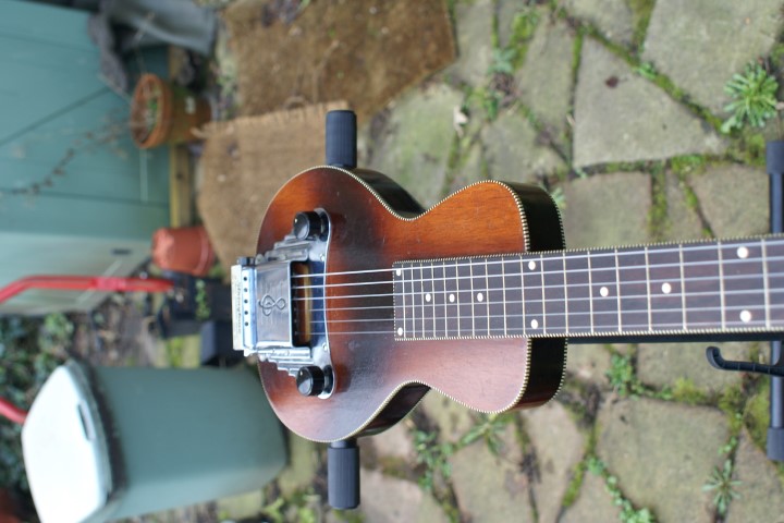

Postby michael murray » Fri Jan 25, 2013 5:08 pm
The pickup.
The guitar.
