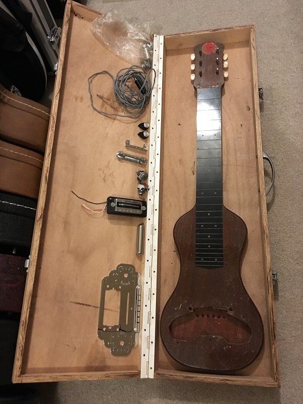

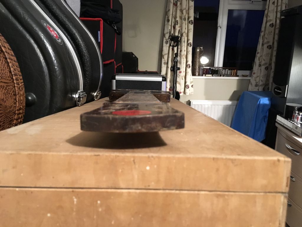

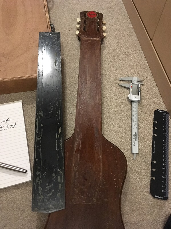

Postby Jennings » Fri Mar 01, 2019 6:29 pm
These give you a favour of the instrument, and the state it's in! And yes, someone in the past has crudely cut out the control plate for a Hofner blade style pickup! But then went to the trouble of re-chroming the control plate! I was hoping to have a pickup maker I've used before wind me something in the style of the original, and mount that to a plate that I'll then mount over the hole cut for the blade.

Postby Mcneilwaeasteel » Fri Mar 01, 2019 7:20 pm
A picture is worth a thousand words, it doesn't look that bad, try leaving it outside in a dry place out of the rain but with it uncovered for a couple of days and nights to let the night air and moisture get back into the wood.
Then have a plank and clamps ready to clamp it, slowly heat the top of the neck on a radiator until a bit of warmth is in it as Keith mentioned, then clamp it down and wait a few days before releasing it. :roll:
Make sure you have a flat piece of wood to place over the whole of the headstock and under the clamp to avoid any pressure point on the headstock that could split the thinner wood.
With some moisture back in the wood it should straighten out when slowly clamped without damaging it.
It's a case of try it and see without doing any damage, good luck we await your achievements with interest. :guitar:
