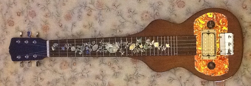

Postby nevada150 » Sun Feb 02, 2014 5:58 pm
Hi, it's Keith again.
I've finished assembling the Gibson BR4 project and I'm not completely happy with it! As the attachment shows, the pickguard is much more "in yer face" than I expected and far "outshines" the rest of the guitar. The beautiful "deco" fingerboard was meant to be the focal point of the guitar along with traditional body and sound. Never fear though, I have a darker piece of "tort" ordered, then it's back to the Black and Decker Workmate in the freezing garage again, brrr. Could bring it indoors on a sheet, but the "boss" might object.
One small observation which could draw some comments. The 4th string (GHS C6th Strings) doesn't seem to have the same projection as the others when I use the steel. Maybe it's my technique as I'm not really used to playing lap steel. I think I may need a bit more pressure on the steel along with correct left hand damping behind. Having said that, the sustain is very good when played unplugged and played on open strings, as one would expect from a 1940's piece of mahogany.
I tried to make it modern with humbucker series/parallel switching and tone bypass using push/pull swithches onboard, but the body cavity isn't deep enough to accommodate even mini pots/switches. Gutted!! So it's back to traditional sounds for the time being and that's good enough for everyone. (Could fit mini throw switches in the pickguard, just mulling it over)
I would appreciate any comment on the above post.
Keith.

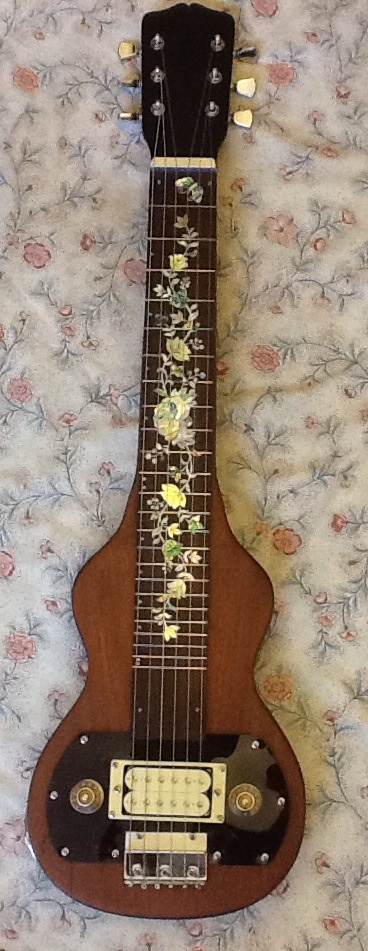

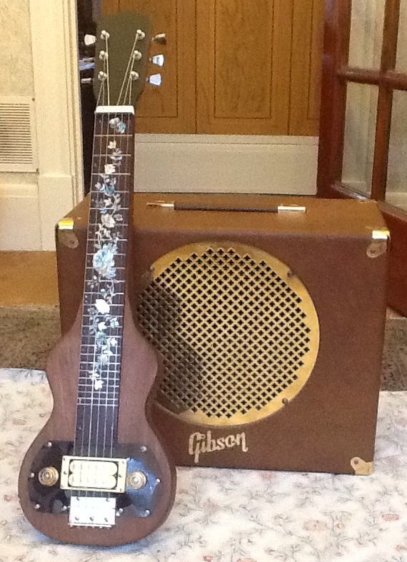

Postby nevada150 » Wed Feb 05, 2014 3:59 pm
Hi all,
Thanks for the replies and good information I received from a few people.
The project is now complete and has been played to the best of my limited abilities. I dumped the light pickguard and made another using darket "tort". I also bought some CTS pots and even I can hear the difference they make.
I've attached a picture of the finished job.
I also have an extended "loan" of a Gibson EH150 re-issue amplifier, courtesy of my brother, so I should be able to make some noise.

Re: Project
Postby nevada150 » Wed Feb 05, 2014 4:47 pm
Just the guitar.
