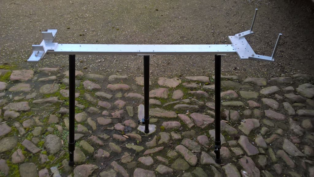

Here's my latest project using some aluminium that was left over from years ago.
In the photo it's in the "pre-dressing" stage - it will get a lot of padding over the scratchy parts very soon. There are a lot of tapped holes in the end plates so that the two guides for the guitar neck and/or head can be fixed at different places to cope with varying widths - you can see how they have a slot to slide on the bolt for fine positioning, and can even turn the opposite way round. At the tail, the two arms also have a number of positions so that the standing rods can bear on the guitar tail, should it be curved or square. The legs were £29 from "Gear4Music" and meant to hold one of the budget 'entry-level' guitars

Postby Tony Russell Davis » Tue Mar 30, 2021 12:40 pm
Danny Mitchell wrote:Good job, Tony. Did you build this with your 10 string plank?
Yes, turned it strings side down onto trestles, so I had had a flat surface to drill onto :lol:
But if you mean 'for' the 10 plank, yes; with the parallel sides it'll sit on nicely and so will the Harmony H7 'Roy Smeck' (a long "triangle" type) and my guitar-shaped home-mades. I'm still thinking through the protective issue, cork? foam plastic? or rubber? The plastic idea looks OK, 'cos I've got some that came with electrical goods (not the polystyrene stuff - tougher than that) but maybe it needs covering with felt or similar to finish it off. Whaddya think?

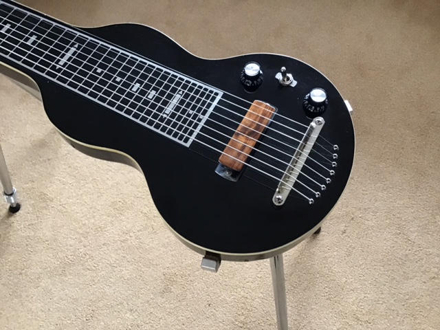

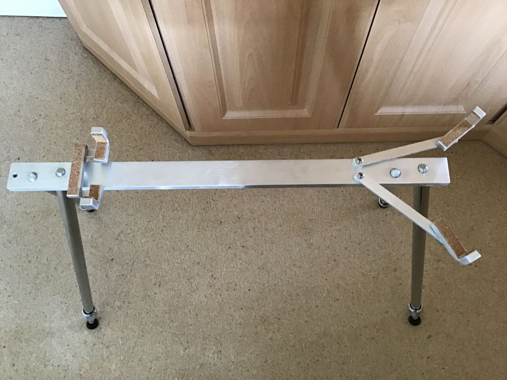

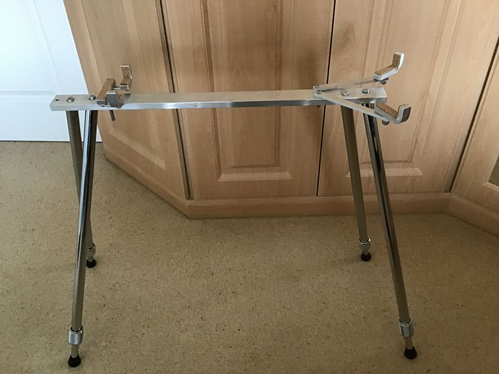

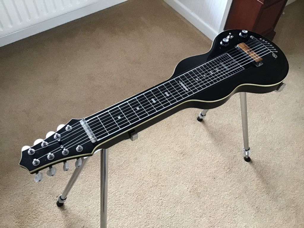

Hi Tony
I have enclosed a couple of pictures of my lap steel stand where all parts making contact with the instrument are covered with cork.

coolsteel wrote:Hi Tony
Nice job, Richard. Is that a Sierra Lap Steel? Looks great.
Re: Guitar stand
Postby coolsteel » Wed Mar 31, 2021 3:37 pm
Hi Danny
It’s a George Boards Stealth model it has a lovely tone and lots of sustain.
