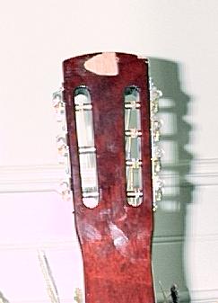

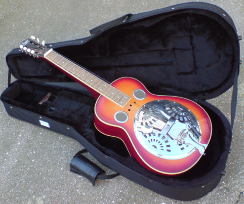

Mine's a Regal squareneck with a Quarterman cone. Originally a Paul Beard set-up, I bought it from a guy in Kentucky. The neck is wide enough for the extra string and if you "flare" the nut (make it a tad wider at the top) you can use the whole width of the fretboard. Beard had put the additional peg right in the top of the head. I took that out, filled the hole (see pic. taken during job) and made a neater job by using half a set of mandolin machines on one side (dowelled the three pegholes and re-drilled for four). You also have to slip in a new bridge saddle that bridges the gap in the spider as the extra string goes straight up the middle. That makes it a little tricky to reach the cone tension bolt, but you shouldn't be tinkering with that much anyway once it's set. Drill a hole somewhere on the centreline of the tailpeice and file a slot to match the other string anchor points. BTW; I get the bone to make nuts by robbing the dog! He "seasons" it and I bandsaw and file to shape :lol: .

All best, Tony.
